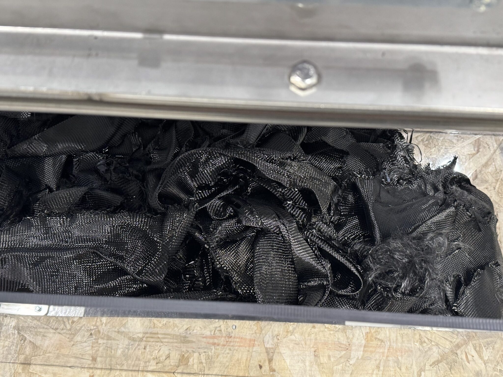

"Gruppo HERA" amongst their many capabilities is one of the first companies in the world to recycle carbon fiber-carbon fiber is of course used in a number of different items including auto bodies and aerospace components for companies such as Leonardo (we have to add that carbon fiber is also used in furnace fixturing which means in theory that CFC fixtures can be recycled). This particular location is in Imola, Italy.

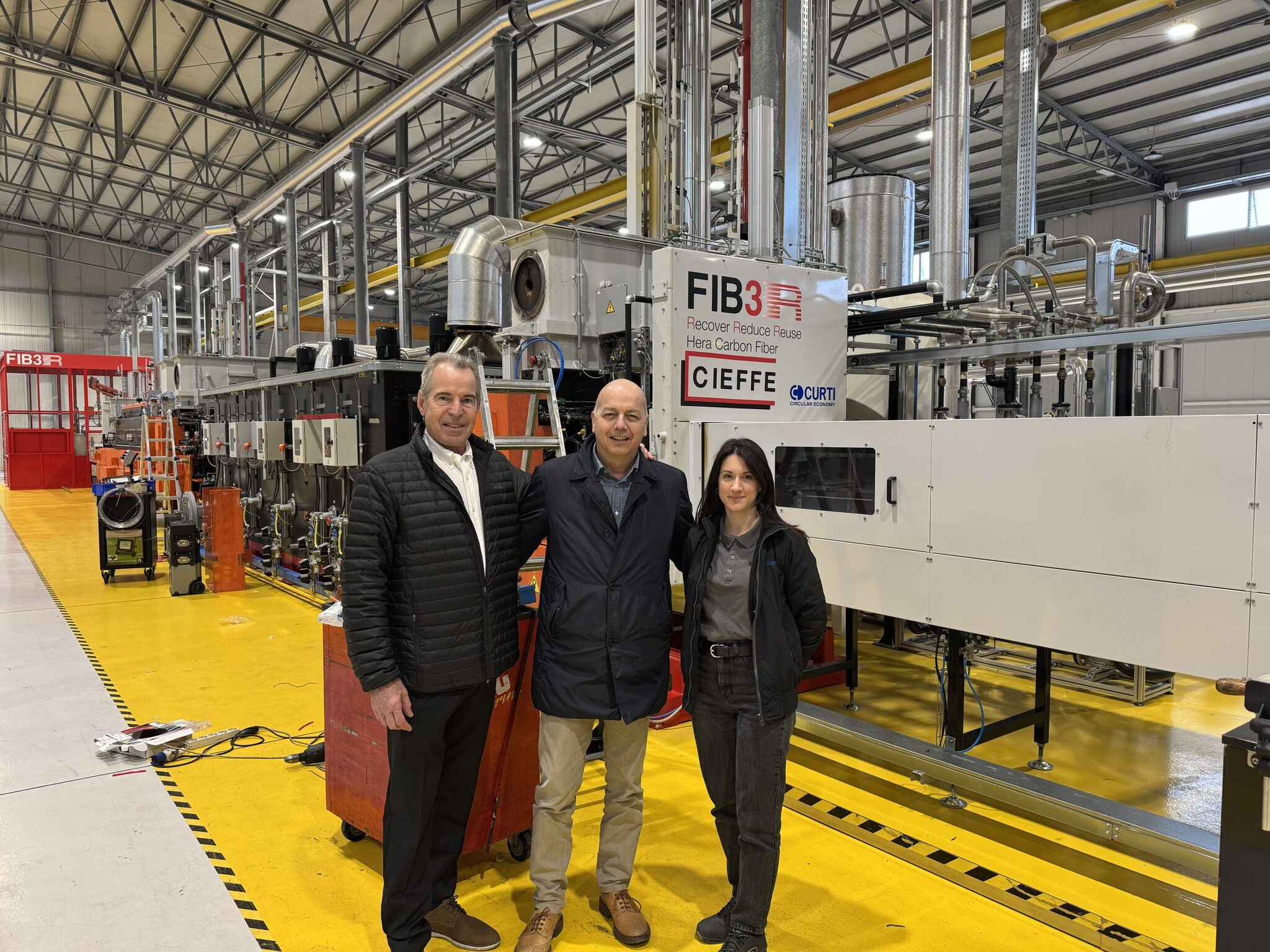

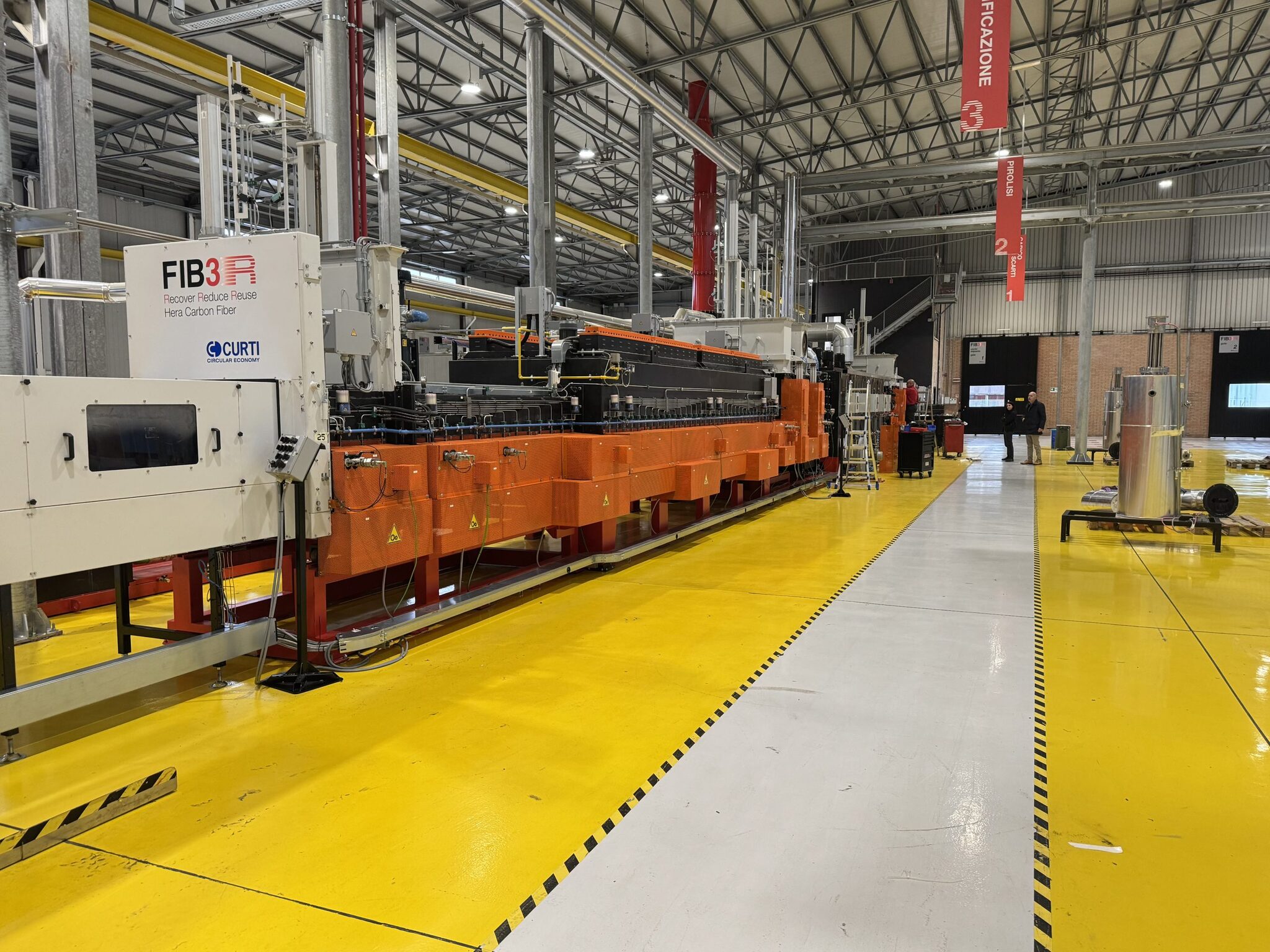

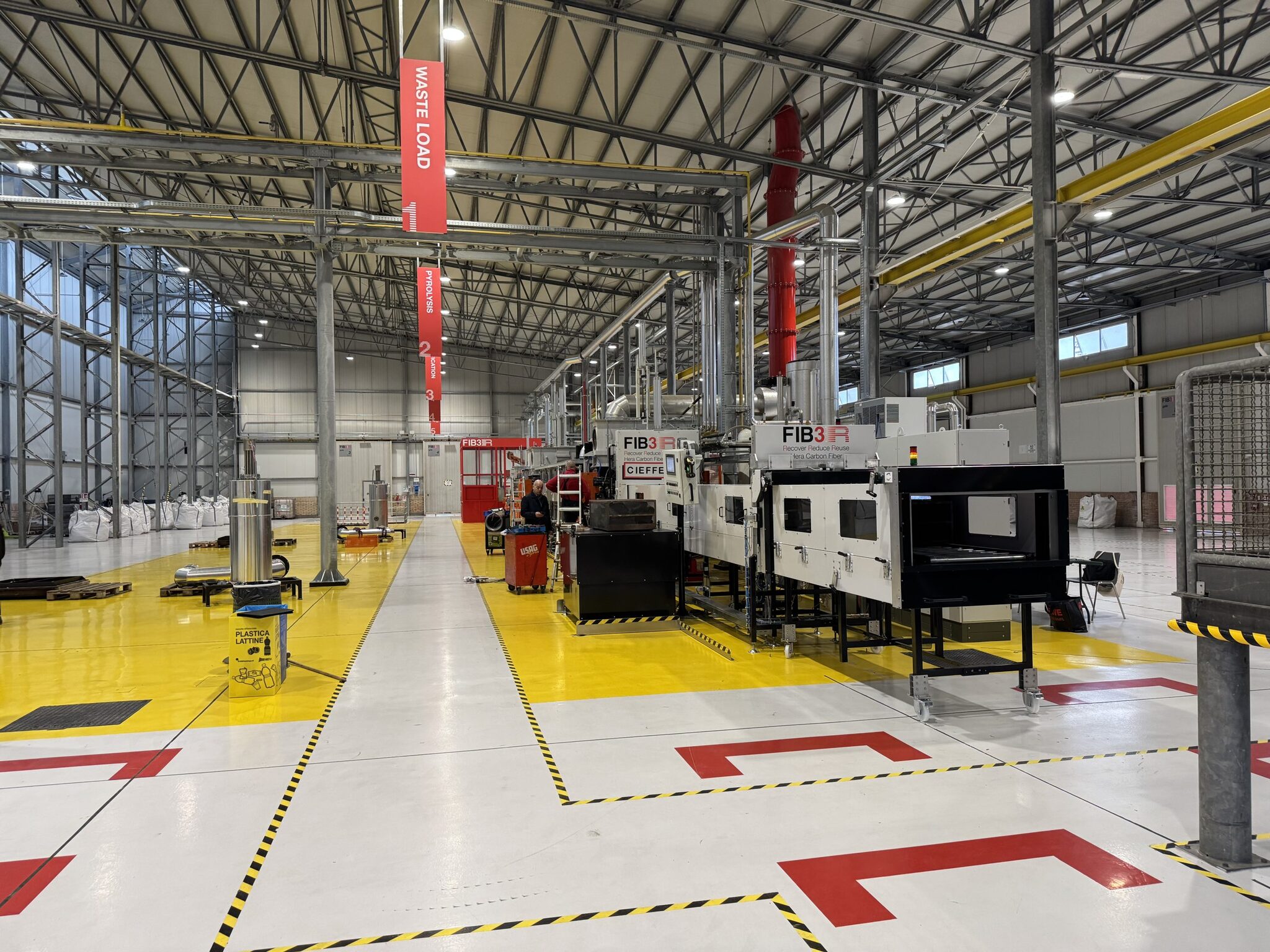

What you see in these pictures is one of the first thermal processing systems in the world for recycling carbon fiber. It was installed in 2024 by "Cieffe" and entered production early this year.
The system is a combination "chain drive" and "roller heath" furnace operating at 500C under an inert, nitrogen atmosphere. Scrap carbon fiber material is loaded into stainless steel baskets with 15 baskets at a time in the system with the entire process taking 2-3 hours per basket.
Currently this is the only system of its kind in Italy and quite possibly the world. Currently plans are in place for other similar systems.
