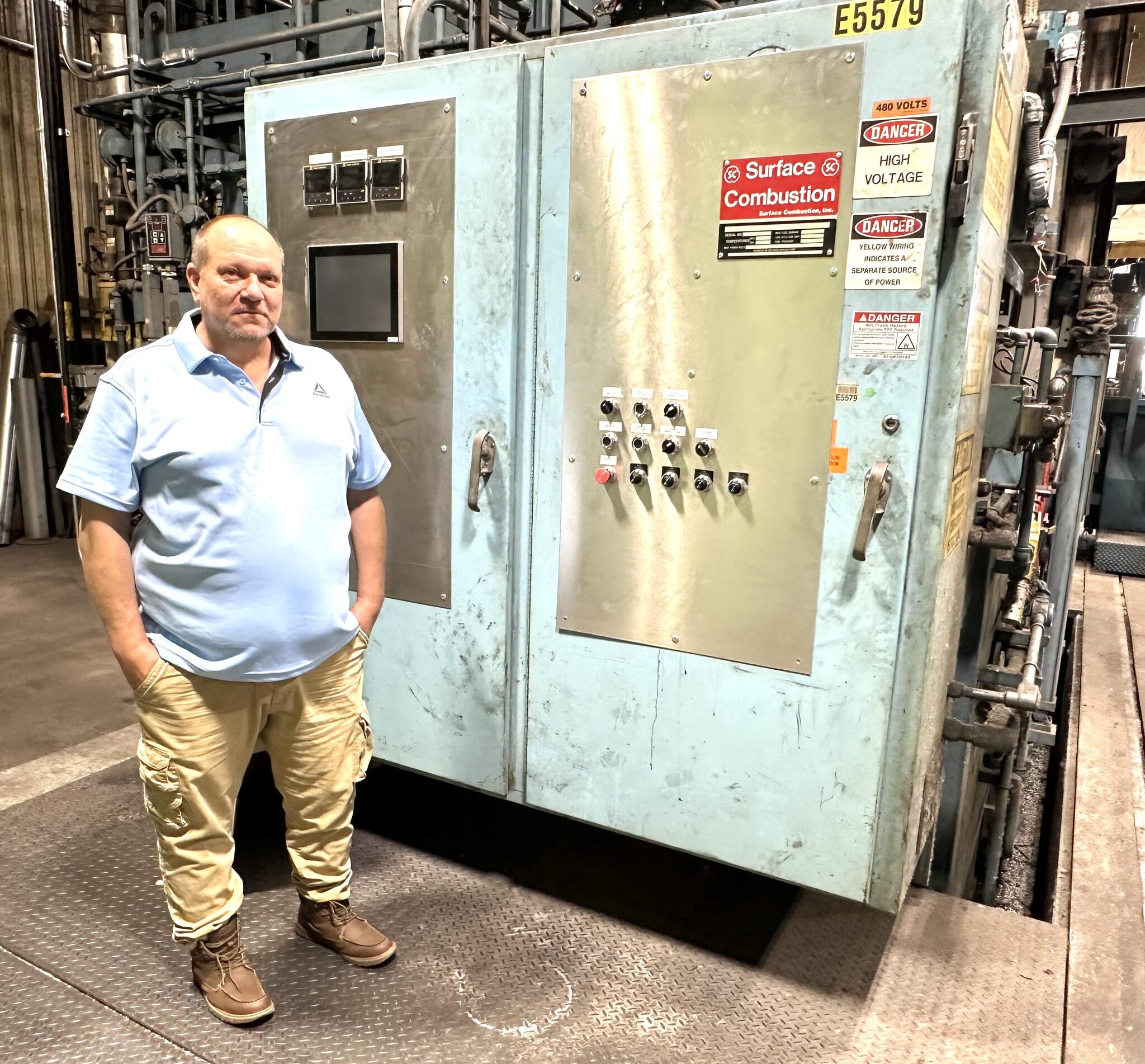

During our visit we had the chance to speak with Mr. Hector Simental, Plant Manager at the Queretaro location and his team who shared with us some very interesting information about their heat treatment department and its’ challenges. The in house heat treatment department is a combination of continuous furnaces (7 in total) and batch IQ units (4), volumes determine which parts will be run in the continuous and batch furnaces. The firm has always felt strongly that heat treating is a “core competency and will remain in house-in the words of Hector “this allows us to control our own destiny”.
As is the case in many areas, CO2 emissions are a constant concern and in this case Tremec is being mandated by the Mexican government to reduce emissions which has lead to many discussions about gas heating vs; electric and induction heat treating as opposed to atmosphere heat treating-we would imagine that these issues will not be resolved for some time. Along the same lines the debate about electric vehicles compared to internal combustion vehicles has played havoc with production predictions, just as it has around the world. (incidentally the furnaces are gas heated).
This is a world class facility and the heat treat department is absolutely immaculate as you can see in one of these pictures. Hector can be seen in the center of the photo taken outside the facility. We thank the entire “Tremec” team for their time and their top notch hospitality.”

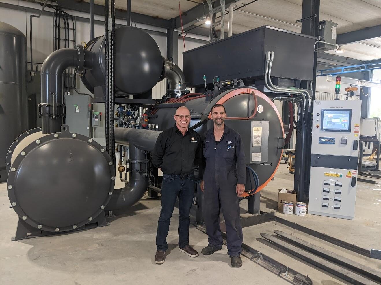

July 9 2020. “Burloak Technologies Installing In-House Heat Treatment Department; In Burlington, Ontario, Canada we find Burloak Technologies who describe their company thusly;  “Burloak Technologies is Canada’s leading supplier of highly engineered additive manufactured components for demanding applications.” https://burloaktech.com/ The company makes our news section today due to the fact that for months, if not years the company has been planning their brand new, state of the art in house heat treating department and just this week one of the first pieces of equipment arrived-a new Titan vacuum furnace from Ipsen in Rockford, Illinois, USA. Installation and Nadcap qualification are the next steps. Future plans are very ambitious to say the least, with several more large pieces of equipment on order, this includes a furnace for processing aluminum. Additive manufacturing is proving to be a rapidly growing market for furnace manufacturers, already this year we have announced several large heat treatment investments in the field and we would expect this will grow rapidly in the future.”
Pleasant Prairie, WI – August 26, 2024 – PAI Industries, renowned manufacturer and distributor of high-quality parts to the heavy duty truck industry, has partnered with ECM to bring heat treatment in-house with a NANO vacuum furnace system. Adding to the already impressive 112,000 ft2 manufacturing facility with state-of-the-art machinery in Suwanee, GA, and exemplary outsourced heat treating, this in-house system expands PAI’s capabilities to expedite production and increase capacity.
Transitioning from primarily out-sourced heat treatment to in house vacuum technology, they will be able to perform low pressure carburizing and through-hardening 24/7 – thanks to the modularity of the ECM NANO system, an external loader, 3- position temper oven & queuing positions. Additional benefits provided by vacuum technology include: no IGO, zero CO2 furnace emissions, no fire hazards/open flames, increased repeatability, and improved metallurgical results. Prior to project acceptance, testing was conducted in the ECM NANO located in the ECM USA Synergy Center (Pleasant Prairie, WI) to further validate improved metallurgical properties.

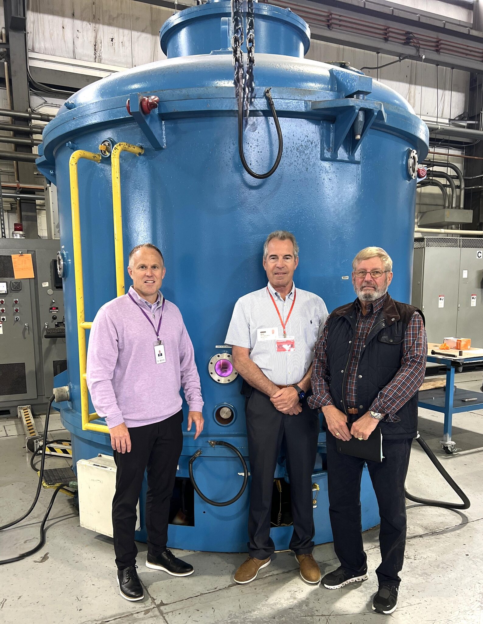

“Why a Vertical Vacuum Furnace? Contributed by IPSEN USA; When you walk into a heat-treating department and see your first vertical vacuum furnace, you’d be forgiven for staring openly at the jaw-dropping sight. There, perched a story or more in the air on metal legs, is a gigantic vacuum pressure vessel. Wires and hoses, pumps and controls—all attached at various angles—could draw comparisons to science-fiction icons like the Iron Giant or the alien spacecraft from H.G. Wells’ War of the Worlds. They are magnificent machines. Awe inspiring. And, most importantly, very useful.
Looking Closer – Why Buy a Vertical Vacuum Furnace? Abar Corporation started producing large bottom-loading vertical vacuum furnaces in the 1960s, most notably building the largest of its kind at the time in 1969 with a gigantic 96-inch by 96-inch work zone (pictured above). “Aerospace companies on the east coast started buying multiple Abar vertical furnaces, lining them up in a row to meet the demands of the space race and the growing commercial aircraft business,” said Mark Heninger, Ipsen’s Director of Equipment Sales. By the time Abar and Ipsen merged in 1985, vertical vacuum furnaces had a steady demand. While these furnaces could do just about everything their horizontal counterparts could do—annealing, carburizing, hardening, tempering, etc.—the vertical furnaces could uniquely handle delivering heat and quenching with a high level of control for very large or very long cylindrical parts with varying thicknesses. Picture a cross-section of an aircraft fuselage, or the engine nozzle of an orbital rocket.(COMPLETE STORY AT https://themonty.com/why-a-vertical-vacuum-furnace-contributed-by-ipsen-usa/“
