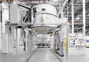

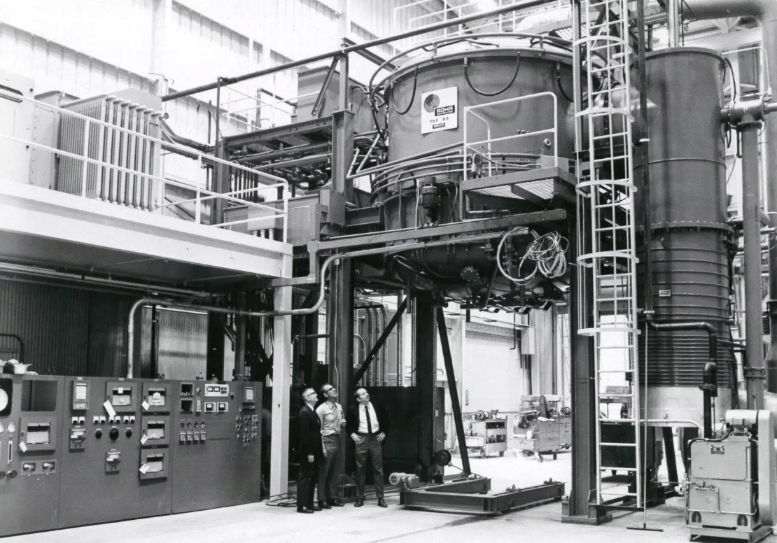

Abar Corporation started producing large bottom-loading vertical vacuum furnaces in the 1960s, most notably building the largest of its kind at the time in 1969 with a gigantic 96-inch by 96-inch work zone (pictured above). “Aerospace companies on the east coast started buying multiple Abar vertical furnaces, lining them up in a row to meet the demands of the space race and the growing commercial aircraft business,” said Mark Heninger, Ipsen’s Director of Equipment Sales. By the time Abar and Ipsen merged in 1985, vertical vacuum furnaces had a steady demand.

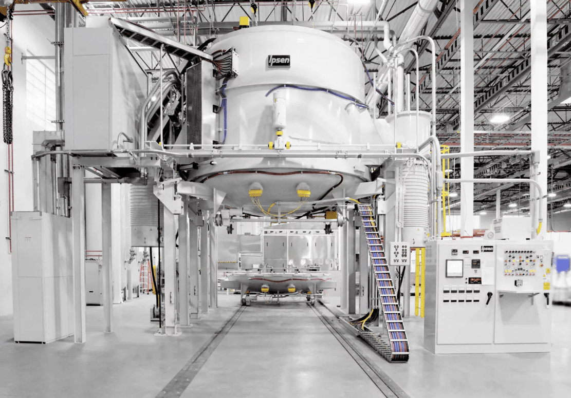

Bottom loading vertical vacuum furnaces allowed huge pieces like this to be sitting flat on the hearth or suspended from the top on a jig within the hot zone. This allowed engineers to take advantage of the geometry of the whole diameter of the chamber, not be restricted by the cross-section width of the pressure vessel at different elevations above the hearth like they might in a horizontal furnace.
“If I have a part that I’m laying down in a cradle on a hearth, and it’s going to grow in a way where I can’t control the expansion coefficient, the weight may cause the piece to warp. However, if I can hang the part, and let gravity allow for it to grow down with neutral loading, I’ll have more consistent uniformity through both the heating and cooling process.” Jim Grann, Technical Director
“When it comes to handling these large parts, vertical vacuum furnace owners are often able to rely on existing overhead crane infrastructure for loading and unloading parts onto the hearth mounted on the traversing bottom head,” Heninger explained.
“Compare that to a horizontal furnace that would require a loader with long forks feeding these gigantic pieces deep into the hot zone. Ensuring the forks remain rigid and parallel over a long travel distance to place the load without colliding with hot zone elements can be expensive,” Grann added. Buying or building a loading system that can handle that rigidity over a long span can add significant cost to the expense of the setup. Storing such a loader when not in use further adds to the overall footprint.

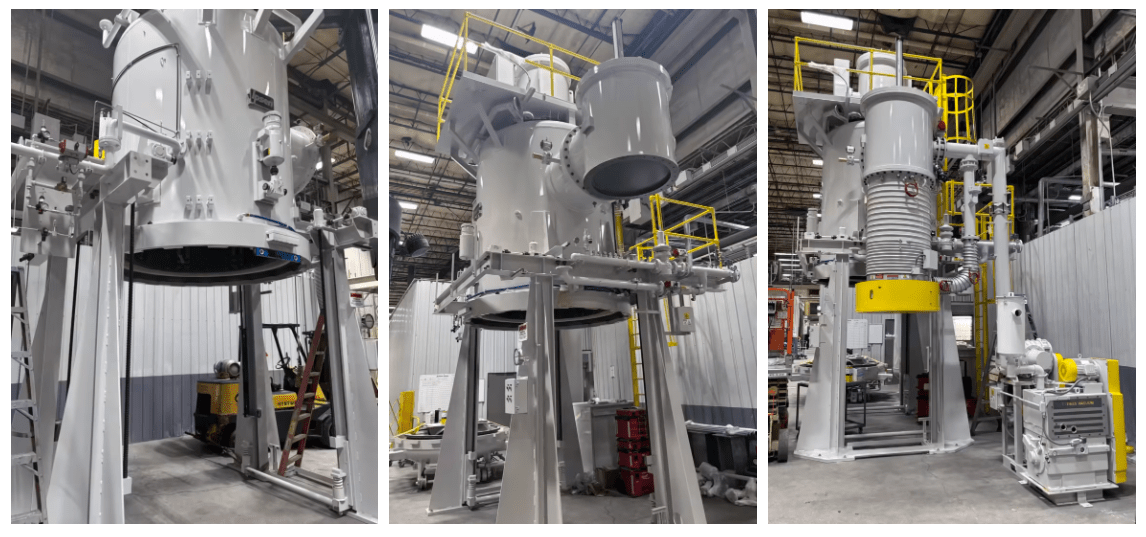

A rarer counterpart to the bottom-loading vertical vacuum furnace, Ipsen’s VTL top-loading furnace also emerged as a solution for incredibly long parts. “Top-loaders and bottom-loaders are distinct furnace types. Top-loaders excel at handling exceptionally long components, such as tubes exceeding 300 inches in length,” said Heninger.
Sometimes lowered into a pit beneath ground-level, these furnaces could handle hardening massive driveshafts for everything from big trucks to oceangoing vessels. “For a top-loader, you need an area for the furnace, but then you also need an area for the part to be lowered into the furnace,” said Heninger.
