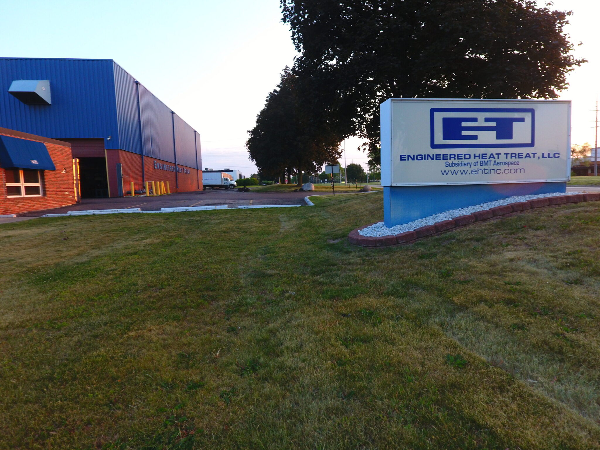

#48 Engineered Heat Treat-Subsidiary of BMT Aerospace
A new entry on our list of “The 50 Largest Commercial Heat Treat in North America” is Engineered Heat Treat in Madison Heights, Michigan, USA. “Founded in 1959, Engineered Heat Treat, LLC provides a variety of heat treat services to the Aircraft, Agriculture, Automotive, Earth-moving equipment, High Performance Racing, Military, and Tooling Industries. As a Nadcap & AS9100 approved company, Engineered Heat Treat’s foundation for quality is coupled with rigorous controls in place for maximum customer confidence and satisfaction. https://engineeredheattreat.com/“
EHT was owned and run by the Pilibosian family until it was acquired by BMT Aerospace of Belgium in 2022, although members of the Pilibosian family are still very active in the company. While the company offers a number of different processes the firm is particularly strong in the aerospace industry. EHT operates out of a 55,000 square foot facility with approximately 50 employees.

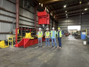

#38 Lark Heat Treating
“Lark Heat Treating was founded in 1978 by brother’s Frank and Gene Clark with the guidance and inspiration of their father, Wade Clark, whose heat treating career started in 1936. Now owned and operated by Frank and Gene, Lark Heat Treating is one of the top commercial heat treaters in the southern United States. Lark operates out of a 55,000 square foot facility and can be classified as a “full service provider” in that they offer most commercially available processes, carburizing, nitriding, vacuum hardening, induction and a few others. https://www.larkheat.com/
During a tour of the plant early in 2024 what “The Monty” found was a commercial heat treater who has been growing and investing substantially in just the past few years. For all the details as well as future plans please follow this link; https://themonty.com/the-monty-visits-top-50-heat-treater-in-texas/?no_cache=1707835733

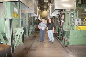

#37 Lone Star Heat Treating
Founded in 1945 Lone Star is one of the older commercial heat treats in the USA. As far as we know the company has always been owned and run by the Van Dorfy family, the current President is Mike Van Dorfy, Jr. Like all heat treaters in Texas, Lone Star’s business is based upon the oil and gas industries although the company has diversified to some extent over the years. Lone Star offers induction hardening, atmosphere carburizing, deep hole drilling and vertical heat treating. https://www.lsht.com/
In February of this year Gord and Dale Montgomery of “The Monty” had the privilege of touring this facility courtesy of Mr. Bud Van Rooyen, Vice President. The story of this visit and the company can be found at https://themonty.com/heat-treatment-in-texas-lone-star-heat-treating/

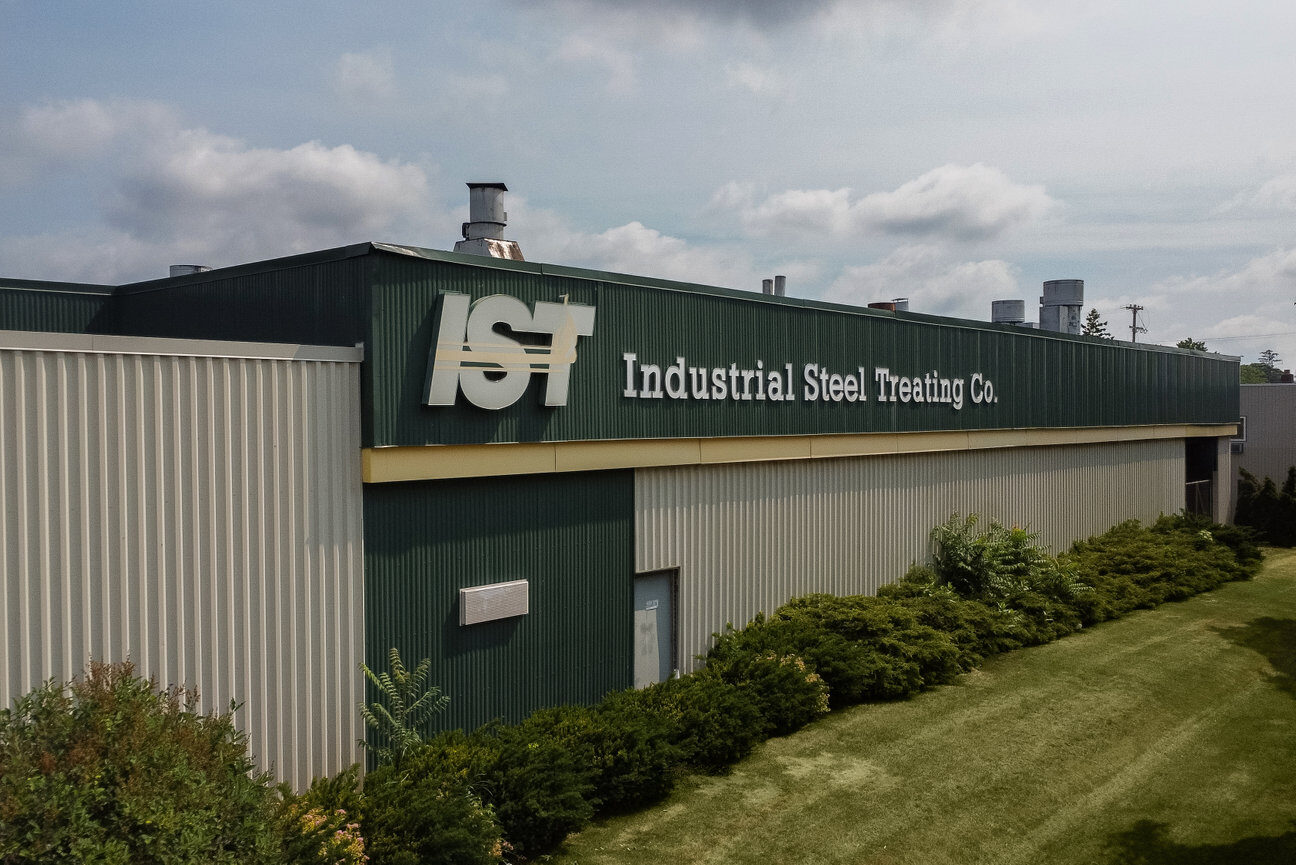

#30 Industrial Steel Treating Jackson
Industrial Steel Treating Company (IST) began operations in Jackson, Michigan in 1943, initially servicing the growing tool and die industry in mid-Michigan, Ohio and Indiana. The company is owned and run by the Levy family and operates out of a 350,000 square foot location in Jackson, Michigan. Two separate, across-the-street facilities house production, prototype sample and warehouse-inventory management capabilities. IST offers gas nitriding, carbonitriding, induction hardening and several other processes. The firm is now fourth generation which few commercial heat treaters can boast of. https://www.indstl.com/

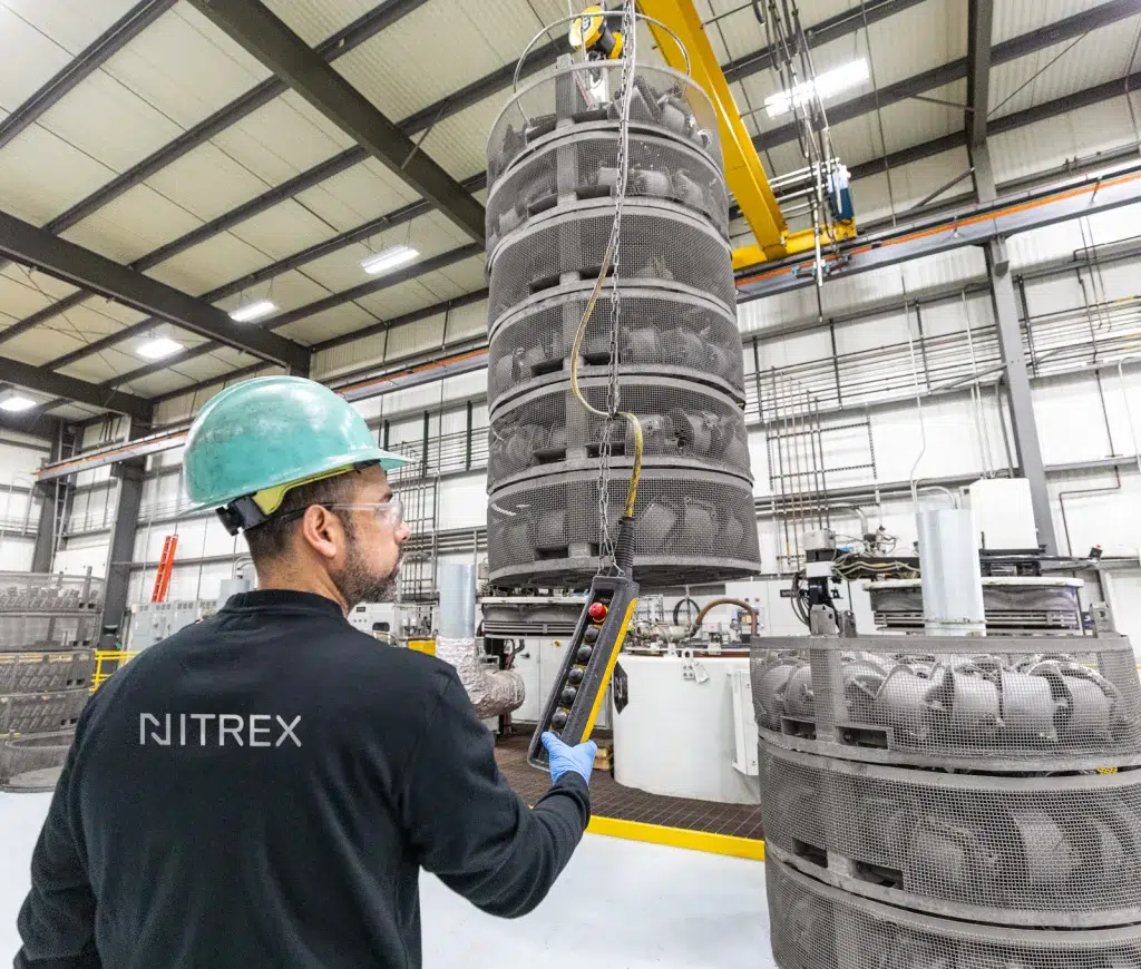

#10 Nitrex
Nitrex consists of three divisions, Nitrex Turnkey Systems, United Process Controls and Heat-Treating Services-our focus is on their heat-treating services in North America. The firm has 4 locations, Franklin, Indiana, Aurora, Illinois, Mason, Michigan and Querétaro, Mexico. While Nitrex is best known for their nitriding services their heat treat facilities offer most processes including LPC. https://www.nitrex.com/en/

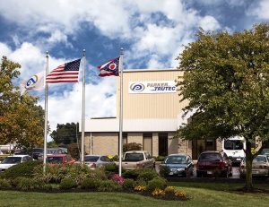

#9 Parker Trutec
Parker Trutec is a North American subsidiary of Japan based Nihon Parkerizing, a very substantial player in the global heat treat industry. In North America Parker has 4 heat treat locations in Ohio, Tennessee, Arkansas and Mexico. The Springfield, Ohio facility is fairly typical of the plants and has this equipment;
  • Salt Bath Nitriding Furnaces (FNC) processing our Isonite process to AMS 2755 (High Cyanide Salt).
  • Salt Bath Nitriding Furnaces (FNC) processing our Isonite QPQ process to AMS 2753 (Low Cyanide Salt).
  • Salt Bath Nitriding Furnaces (FNC) processing our Isonite LiFe process.
  • Gas Ferritic Carburizing Furnaces (FNC) processing to AMS 2757.
  • Batch Carburizing with Dowa, Surface Combustion and AFC-Holcroft Furnaces.
    • Carburizing, Carbonitriding, Neutral Hardening (Quench & Temper), Normalizing.
  • Continuous Roller-Hearth Carburizing Furnaces (Dowa).
  • Vacuum Degreasing Systems for pre- and post-carburizing.
  • Hanging and barrel shotblasters.
  • Vibratory polishing equipment.
Their business largely relies on the Japanese automotive transplants. https://www.parkertrutec.com/

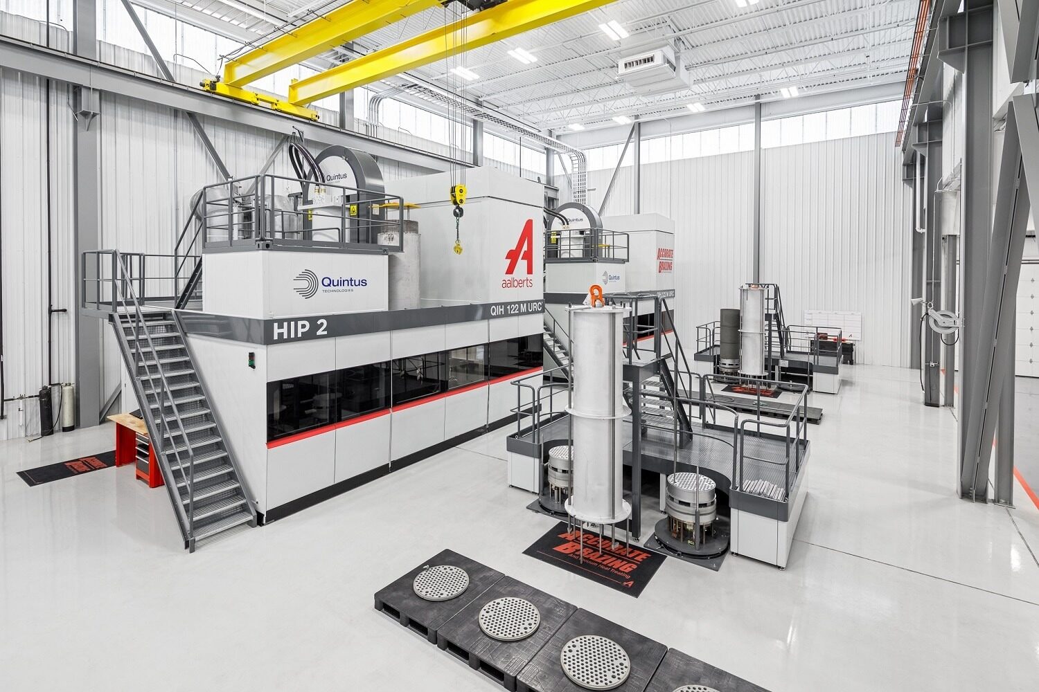

#2 Aalberts
Headquartered in the Netherlands, Aalberts surface technologies has five divisions on three continents and is part of the worldwide leading and globally positioned technology company Aalberts N.V. which has 132 locations worldwide and more than 14,000 employees. Aalberts is committed to adaptation and innovation with a clear focus on customers. For many years Aalberts (under the name Hauck) was one of the largest commercial heat treaters in Europe with a very small footprint in North America. This changed rather dramatically over the past number of years with the acquisitions of Premier Thermal, Applied Process, Alfe and several others which between them offer most forms of heat treating.  We have not the slightest doubt about Aalberts Surface Technologies being the second largest commercial heat treater in North America. https://www.aalberts-st.com/
