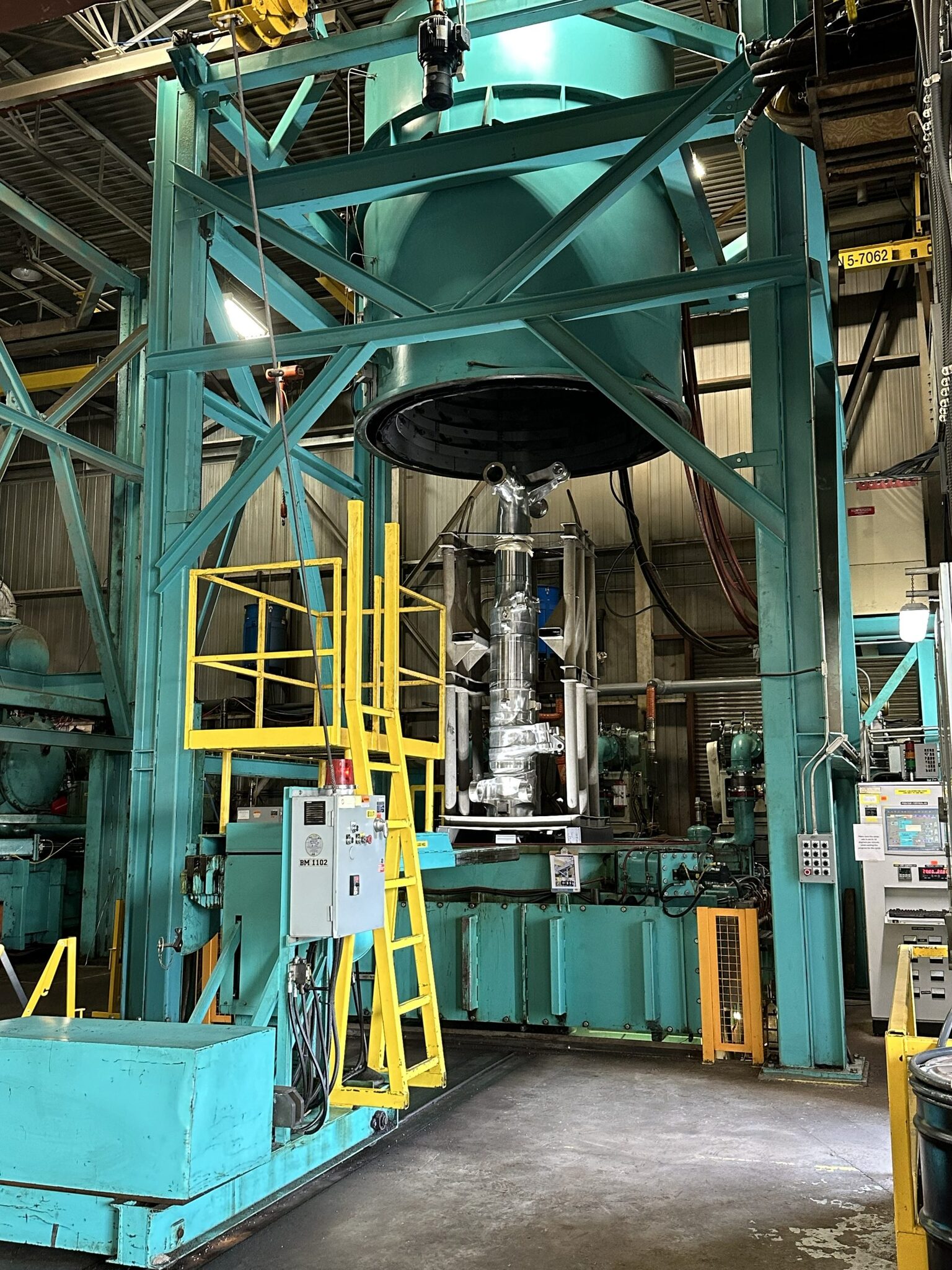

The press release had very few technical details about the furnaces themselves. Can you share with us some information about the size of the furnaces, capacity hot zone etc?DF; The two are:Model VAV6060 HV-2 10^2 range 2-bar quench 60”x 60” 3000lbs all metal hot zoneModel VAV6098 HV-2 10^2 range 2-bar quench 60”x 98” 4000lbs all metal hot zoneBoth systems are designed for high-performance aerospace applications and long-term operational reliability.
Why Vac Aero? Certainly I know that few vacuum furnace builders have the aerospace experience that your company has but at the end of the day the competition for this order must have been fierce. What made Boeing decide to go with your company?DF; That’s a great question, and the answer is straightforward: decades of trust built on results. Our relationship with Boeing dates back to 1965. Over that time, we’ve developed a deep, collaborative understanding of their materials, processes, and production challenges. That experience allows us to approach furnace design not simply as an equipment supplier, but as a long-term solutions partner.One telling example is that Boeing is still operating a Vac Aero furnace that has been running at peak performance for over 35 years. We’ve supported that system throughout its life with hot-zone replacements, control upgrades, and spare-parts support. Customer service and lifecycle support are core to how this Vac Aero grows.Additionally, our expertise in vacuum oil quenching is truly second to none. On the service side, Vac Aero has processed more than 50,000 shipsets of Boeing landing gear, and that legacy performance was a key differentiator in this decision.
Will these be the largest bottom load vacuum furnaces Vac Aero has ever built?DF; No, these are not the largest. We have previously built a larger system—the VAV8484 HV-2, featuring a 10² vacuum range, 2-bar quench capability, and an all-metal hot zone measuring 60” x 98”. That project further demonstrates our ability to scale furnace design to meet demanding aerospace and defense requirements.
