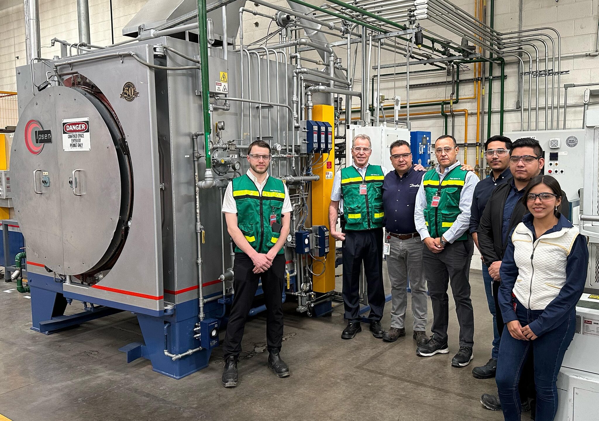

For a variety of reasons Danfoss in 2023 decided to bring this process in house, the reasons include faster turn around times, less inventory requirements and greater control over quality. The end result of this decision was that in 2023 the company invested in a used Ipsen vacuum nitriding system with working dimensions of 36” X 48” X 36” with a 2,000 pound capacity. Danfoss approached SSi Mexico about updating the controls, this update was just completed and testing has revealed that the metallurgical results are everything that Danfoss had hoped for.
