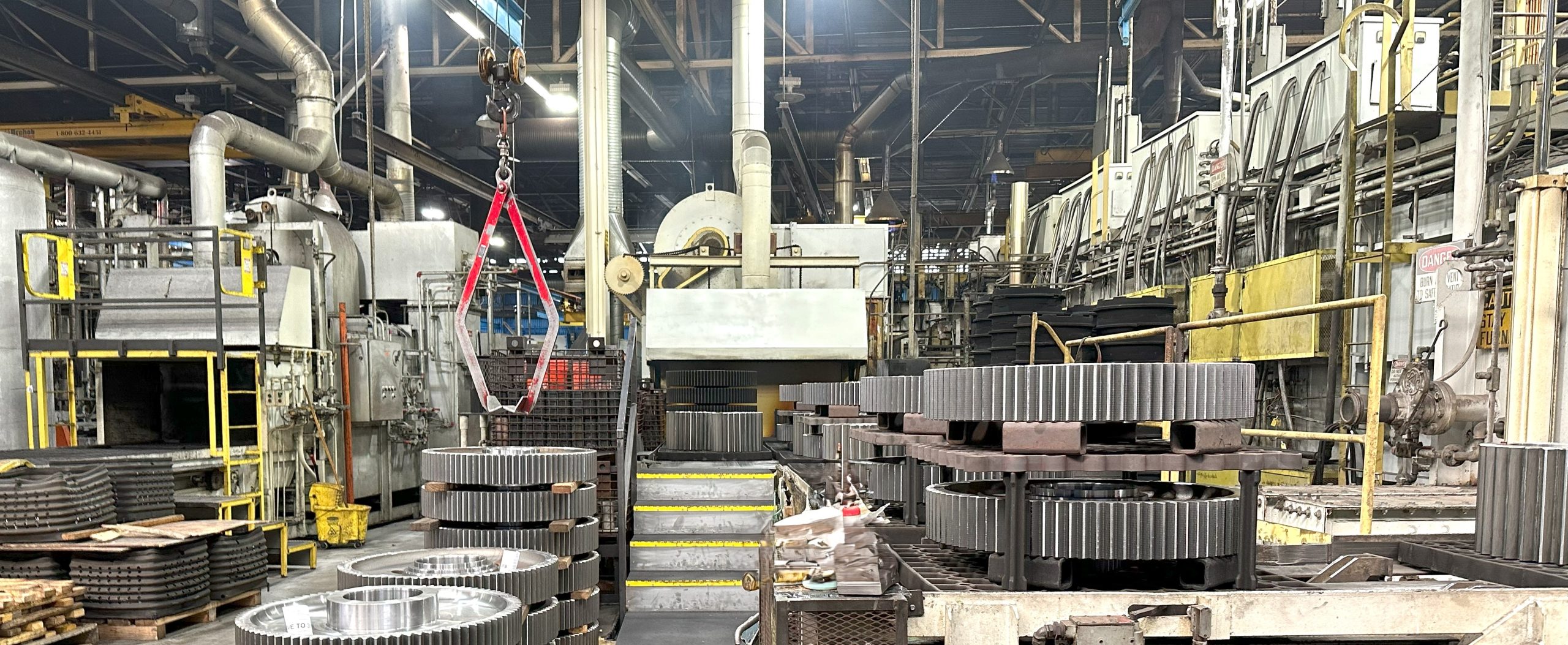

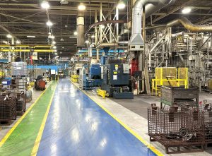

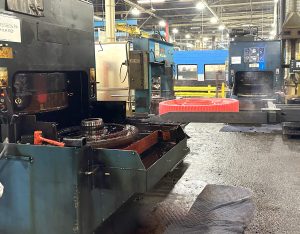

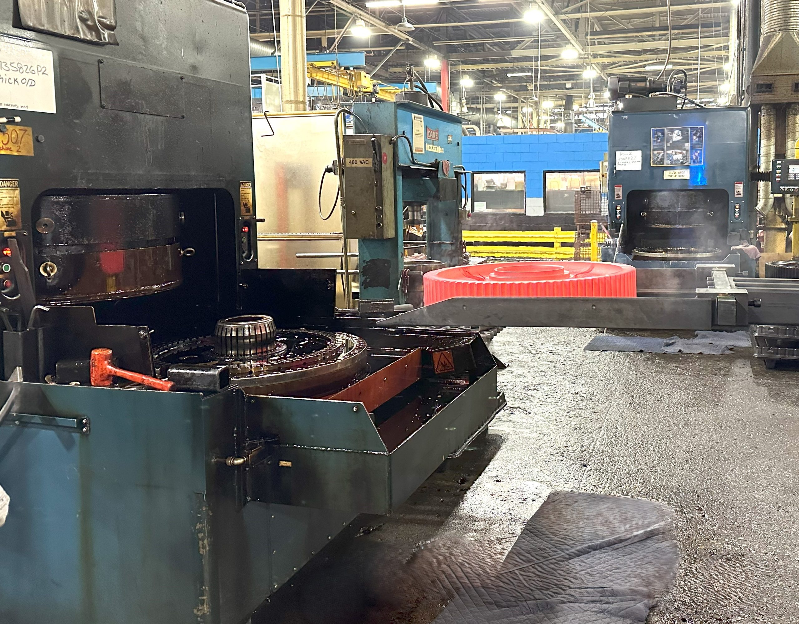

There is no way to describe the heat treat department other than by saying it is mammoth. 80,000 square feet houses 7 two row pusher furnace lines, a large roller hearth hardening line, 2 annealers, 7 batch IQ furnaces, 2 nitriders, 5 induction hardeners (scanning and tooth to tooth), 4 pit carburizing furnaces, 6 endothermic generators and 21 press quench systems. Datalogging and state of the art controls round out the picture of this clean heat treat.
In terms of capabilities the company can process gears up to 36” in diameter, with a weight of up to 900 pounds, shafts up to 2,000 pounds while the Induction systems can handle up to an 80” internal diameter.
