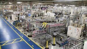

Number 1 Ford Motor Company Sharonville Transmission Facility. We are quite comfortable in suggesting that the Ford Sharonville, Ohio Transmission facility is the single largest captive heat treat facility in North America. Ford was one of the first automotive companies to embrace vacuum carburizing and the end result is that this plant now has 64 ECM LPC cells with 20 bar nitrogen gas quench systems. It is worth noting that this facility has almost 2.5 million cubic feet under roof with almost 2,000 employees;
