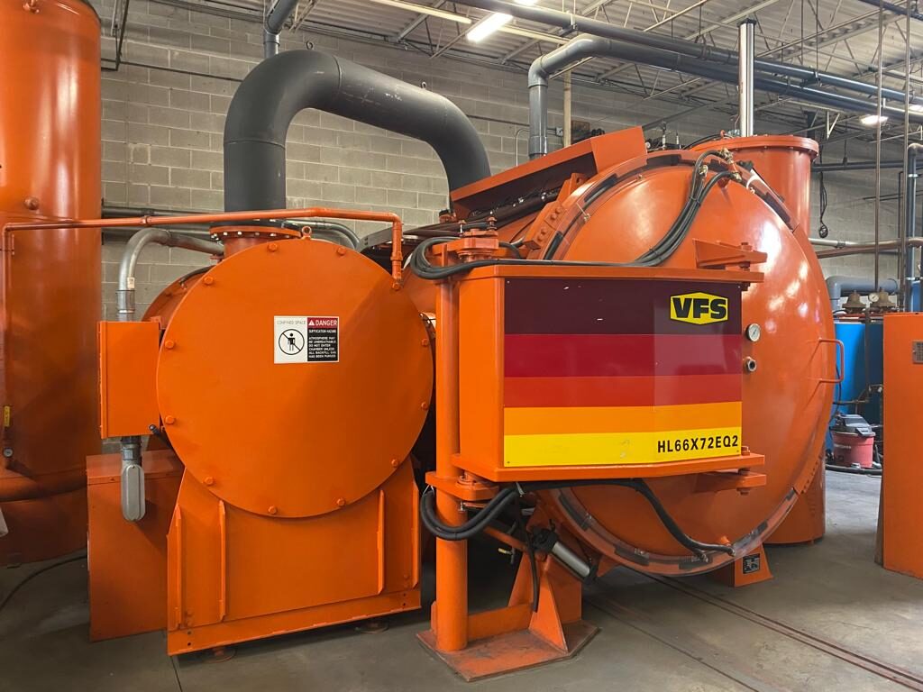

Last year a VFS (Vacuum Furnace Systems) Model HL 66 X 72 EQ2 Vacuum Furnace entered the used market in North America-the complete description said this;
“This is a horizontal loading vacuum furnace manufactured by VFS  6/1997. Well maintained furnace with original hot zone. The furnace water system was on a closed loop system with rust preventative and heat exchanger / water tower open loop side.”
  • Hot zone dimensions; 48” wide X 36” high X 72” deep
  • Maximum operating temperature of 2,650F
  • Weight capacity 4,000 pounds at 2,400F
  • Nitrogen/Argon gas quench up to 2 bar
  • Varian 35” diffusion pump
  • Stokes 412, 300 CFM roughing pump
  • Stokes 615 1600 CFM blower
Asking price for the furnace was $200,000 USD and sale price was $200,000 USD. While the furnace did not sell overnight it sold within just a few months and in our opinion the sale price was fair for both buyer and seller based on brand, condition, age and capabilities.
