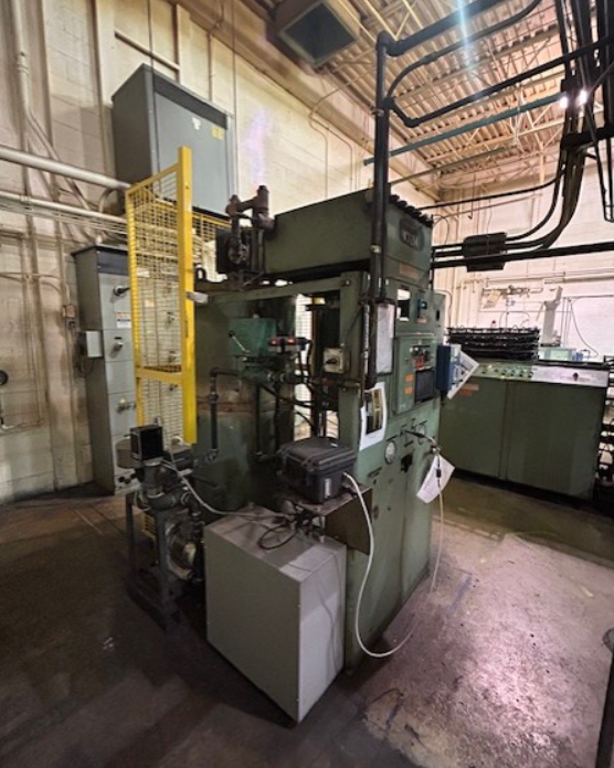

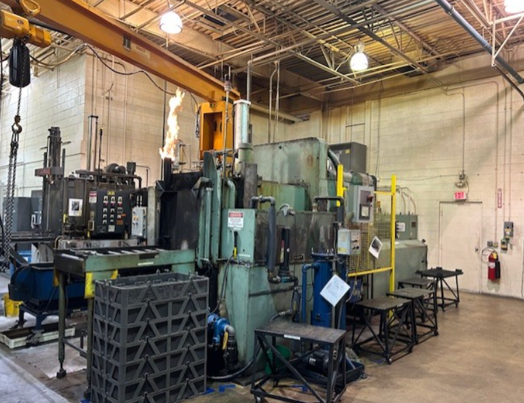

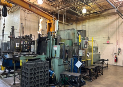

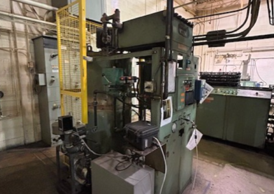

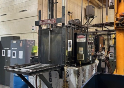

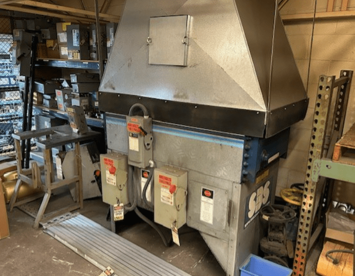

Today we look at a complete furnace line located at a captive heat treater in the US Midwest. The line consists of the following;
  • 24” x 36” x 24” Pacific Scientific IQ Furnace
    • Electrically Heated

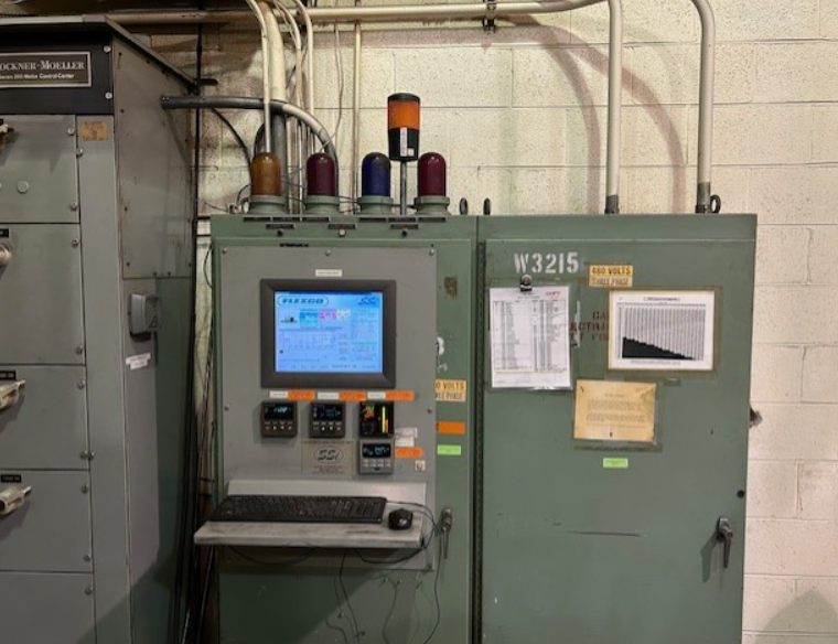

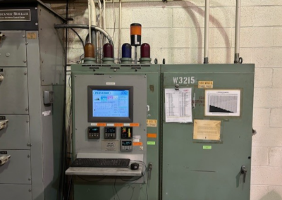

    • SSI Controls
    • Electronic Flowmeters from Waukee
  • Pacific Scientific Electrically Heated Endo Generator
    • With AE Endoinjector

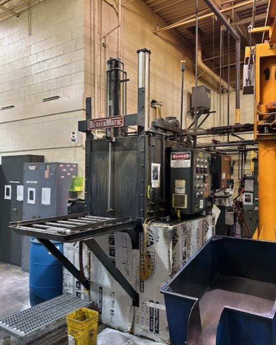

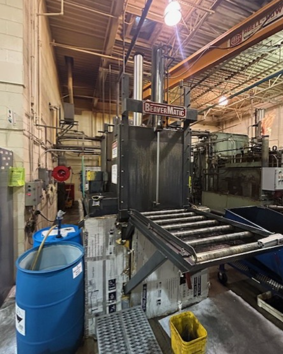

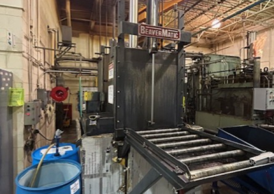

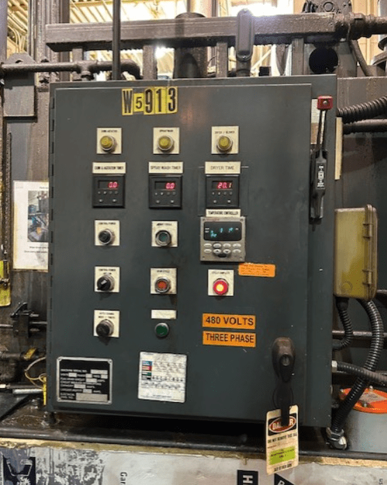

  • 24” x 36” x 24” Beavermatic Washer
    • Smart Skim System

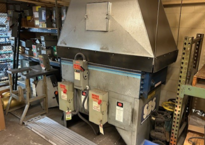

  • SBS Chiller
    • Serial # 4382
The vendor in this case is trying to decide whether this line is worth marketing or straight off to the “scrappers.”
The plus is that this is a complete line with updated controls, in good condition and ready to go. The minus is the brand (Pacific Scientific-as far as we know the company disappeared long ago) and the size. 24″ X 36″ X 24″ is far too small a size for anybody other than a captive heat treater with small lot sizes or a commercial heat treater in a market with small lot sizes such as the western and north eastern areas of the USA and British Colombia, Canada.
