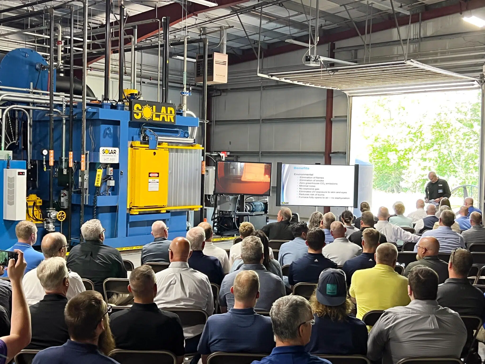

“May 31, 2022 Solar Atmospheres,  a US commercial heat treater who will shortly be gracing our pages again as one of the 50 largest commercial heat treaters in North America announced that they had just commissioned a new Vacuum Oil quenching furnace. To commemorate this event the firm held an open house this past Wednesday and as it turned out it was standing room only. This photo shows Mr. Bob Hill of Solar introducing the new furnace to the 100 plus guests in attendance.
