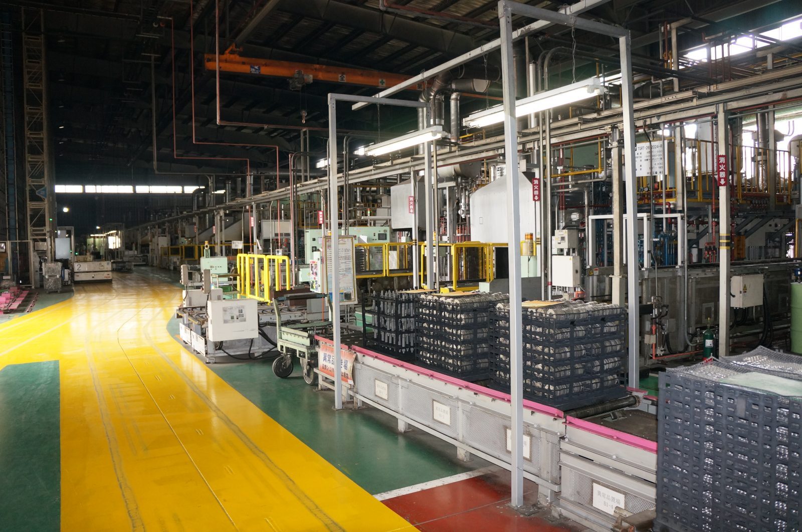

We have to hand it to SECO for selling a vacuum furnace into Japan-it is not an easy job. Japan in our opinion is the most close knit heat treating region in the world with Japanese heat treaters usually always buying from Japanese suppliers and only selling to Japanese customers. Having said that we will also say that heat treating in Japan is second to none. The attached photo shows a commercial heat treat shop we visited a few years back-a top notch operation.
