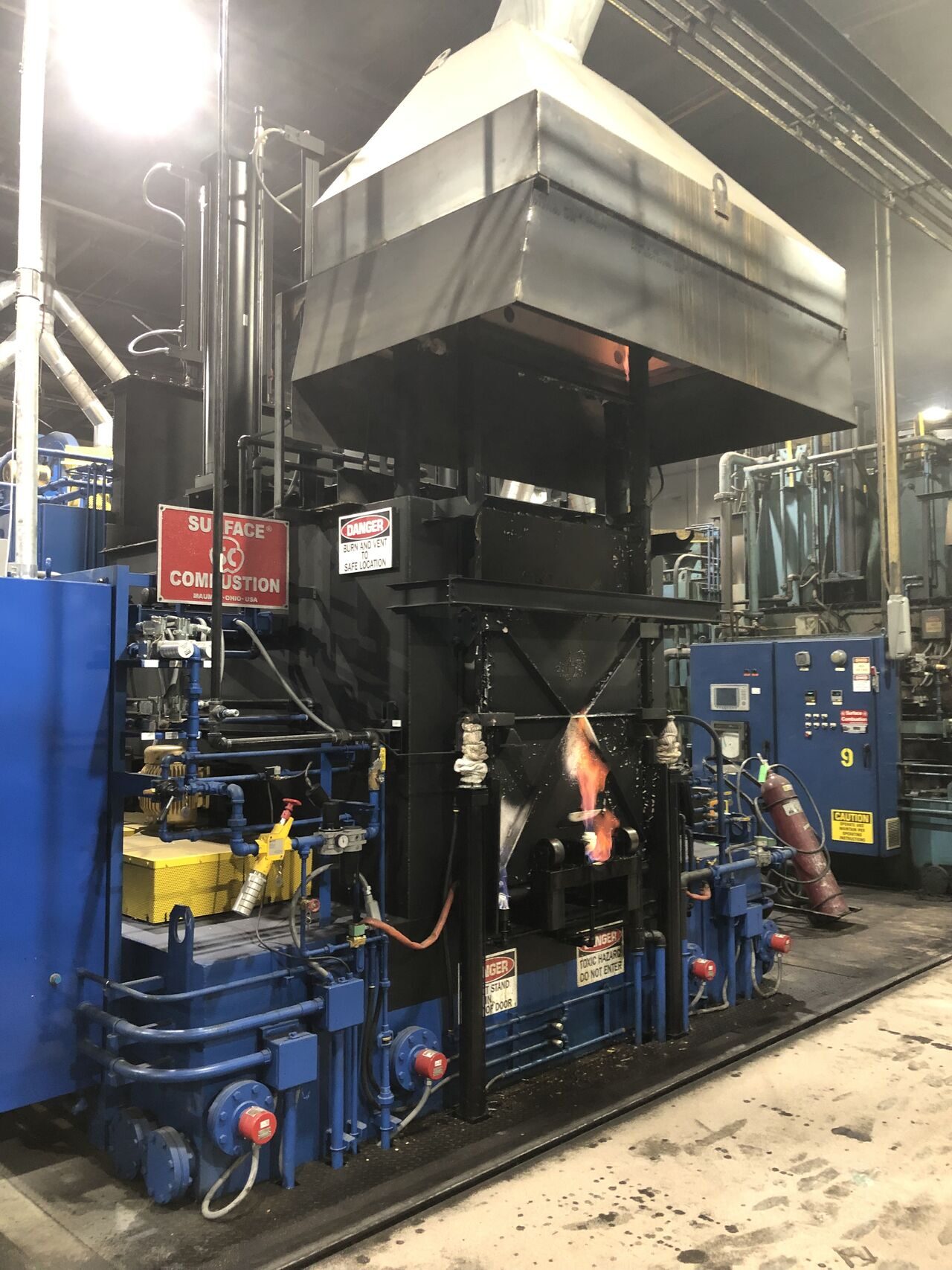

Earlier this year we had this news item about commercial heat treater Bluewater adding more furnace capacity at their St. Marys, PA, USA facility. We can now say that the 36″ X 72″ X 36″ batch IQ furnace is now on line and producing parts. As a footnote to this story we can say that Bluewater has made our list of the 50 largest commercial heat treaters in North America for 2022. This list can be found at https://themonty.com/project/the-monty-heat-treat-news-50-largest-north-american-commercial-heat-treats-2022/
MAY 1, 2022 Commercial Heat Treater Adds Batch IQ Capacity; April 18th as part of our regular “Monday Morning Briefing” we mentioned that commercial heat treater Bluewater Thermal in St. Marys, PA, USA was in the process of adding another batch IQ furnace “The Monty Heat Treat News” with the assistance of the “Bluewater Team” can now provide you all the details about what the firm is adding and what they currently have. https://themonty.com/commercial-heat-treater-adds-batch-iq-capacity/
“The new equipment being added to our Saint Marys, PA facility consists of:
Surface Combustion Super 36/72 Allcase Batch I/Q Furnace (36x72x36)
Surface Combustion Super 36/72 P/M Uni-Draw (36x72x36)
We took delivery on April 6 and are in the process of start-up/commissioning this week. This is our 5th Super 36/72 Surface Allcase I/Q and our 7th Super 36/72 Uni-Draw to be added to our Super 36 line. We have been seeing significant growth in both our automotive and lawn & garden powder metal business segments leading to the need for additional batch capacity. We also offer:
