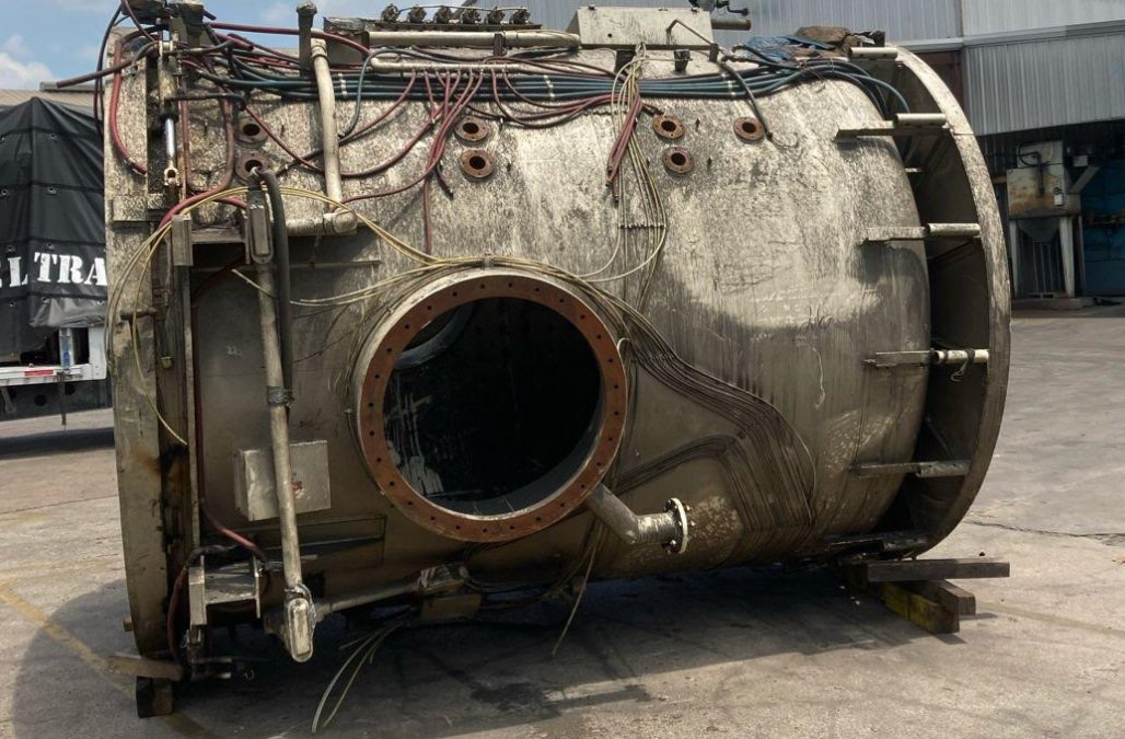

For sale is a small commercial heat treater in the Rocky Mountain, USA region of the USA. This is quite a small operation with sales of under $1 million USD but it is a classic example of how commercial heat treating can be very profitable. This is an absolutely perfect opportunity for an individual to realize his life long dream of owning his own business while at the same time making a much higher than average income. If you would like more details please let Jordan [email protected] know.
