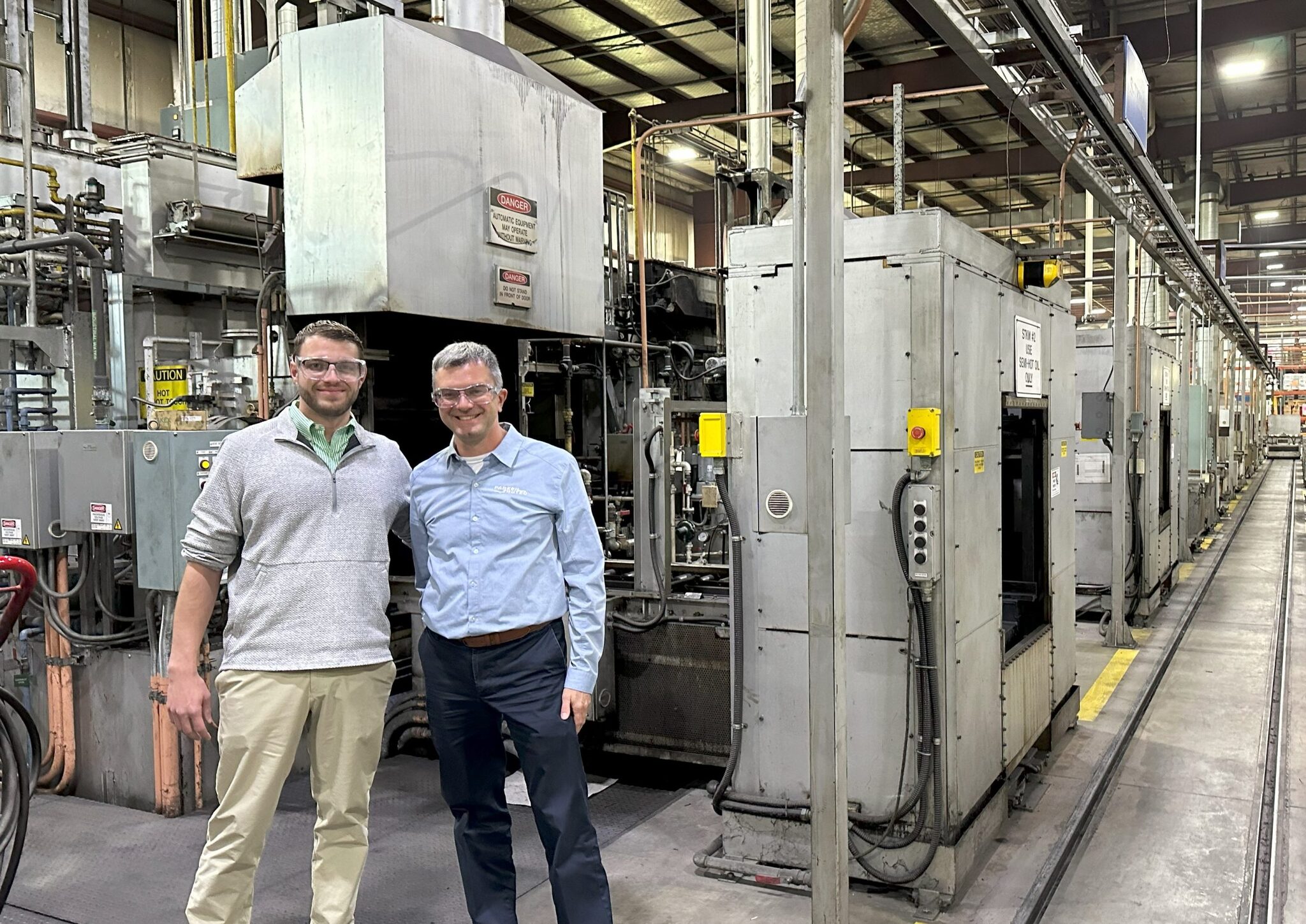

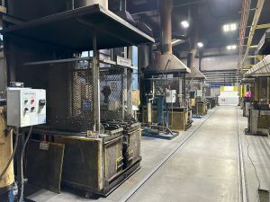

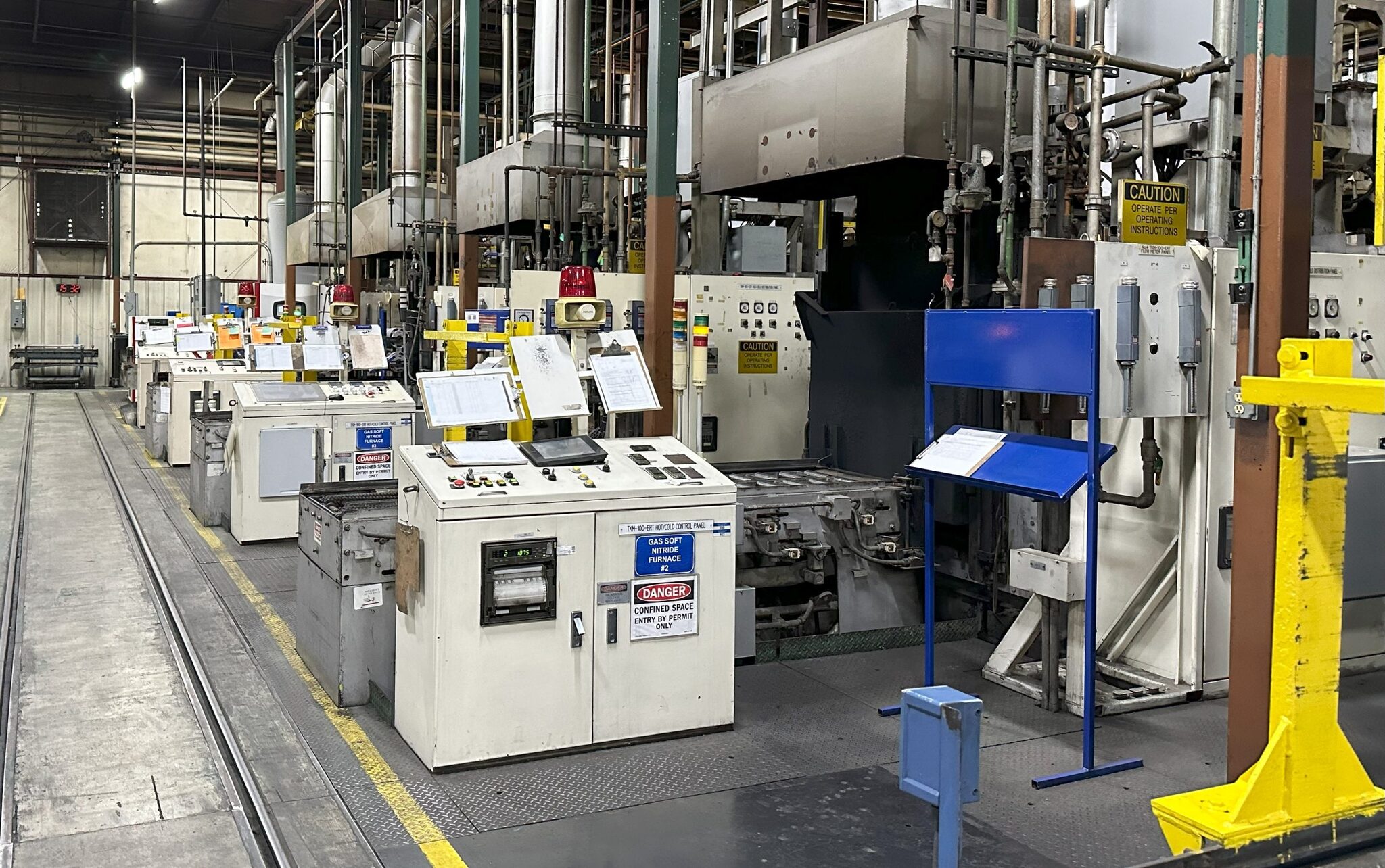

Our visit to the Springfield plant revealed almost exactly what we expected to see, a large, clean, modern facility much larger than the average commercial heat treat which is borne out by the fact that it has over 150 employees. In terms of equipment this is what we saw;
  • Salt Bath Nitriding Furnaces (FNC) processing our Isonite process to AMS 2755 (High Cyanide Salt).
  • Salt Bath Nitriding Furnaces (FNC) processing our Isonite QPQ process to AMS 2753 (Low Cyanide Salt).
  • Salt Bath Nitriding Furnaces (FNC) processing our Isonite LiFe process.
  • Gas Ferritic Carburizing Furnaces (FNC) processing to AMS 2757.
  • Batch Carburizing with Dowa, Surface Combustion and AFC-Holcroft Furnaces.
    • Carburizing, Carbonitriding, Neutral Hardening (Quench & Temper), Normalizing.
  • Continuous Roller-Hearth Carburizing Furnaces (Dowa).

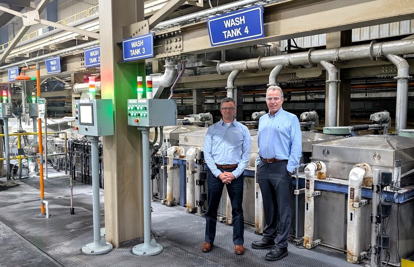

  • Vacuum Degreasing Systems for pre- and post-carburizing.
  • Hanging and barrel shotblasters.
  • Vibratory polishing equipment.
