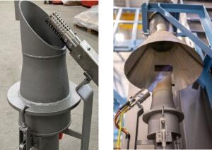

As already mentioned in many articles, the reduction of emissions as well as the energy efficiency of the entire process line are currently one of the top issues in industrial heat treatment processes, especially in Europe. As a result, the perennial questions on the minds of management and chairholders are: Is electric heating a viable option for my heat-treatment facility? Where are the limits of economic viability? What needs to be considered for chamber furnaces and what limitations in the overall process must be accepted? Beside the visually appealing alternatives such as the use of electric igniters instead of gas burners for flaring escaping process gas, some key aspects of reducing the carbon footprint are highlighted below.
