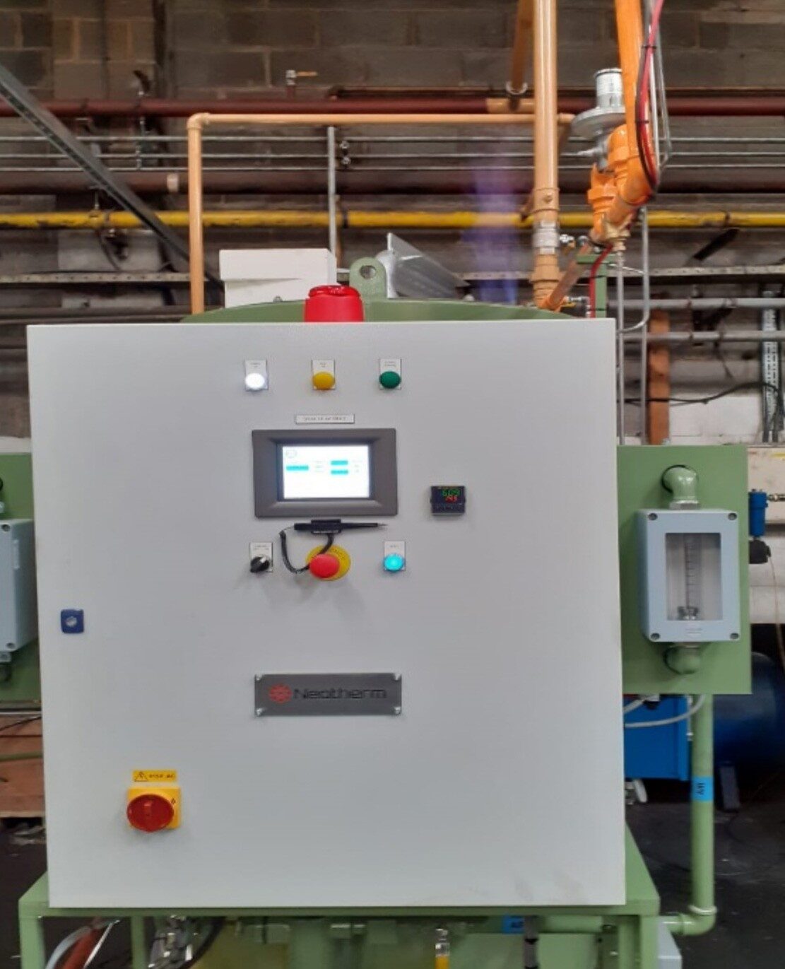

“Endothermic Gas against Nitrogen Methanol – your competitive edge. Your service and quality are comparable to your heat treat competitor, so why is a potential customer going to choose you over them – PRICE. Heat treatment is a high energy process and there is a constant battle for efficiency while maintaining quality. You have streamlined your process flow, automated everything possible, highly maintained your equipment and your furnace utilisation is a dream. So where do you go next? Well, if you are using nitrogen methanol / propane as a process gas, then you could be at a huge disadvantage to your competitor. You may have seen articles which mathematically show that endothermic gas, is on average, 3-4 times less expensive than using nitrogen.
To illustrate this in the real world, we recently had a customer running several sintering furnaces using nitrogen / methanol and their average monthly spend was £16,000, including the tank rental and other costs. Fitting two refurbished endothermic gas generators, reduced this cost down to £3,500! The main concern we run across has to do with PPAP-will you have to re-PPAP components due to a process change? However, this can be overcome by installing a generator while the nitrogen is still in place. By changing some settings, it is then possible to switch process gases to run trials as required. A well refurbished generator will give years of service at a fraction of the cost of a new one. Customers’ staff can be involved in the project to enable them to familiarise themselves with the plant and features of its operation. Please contact me at [email protected], for a no obligation look at your options.”
