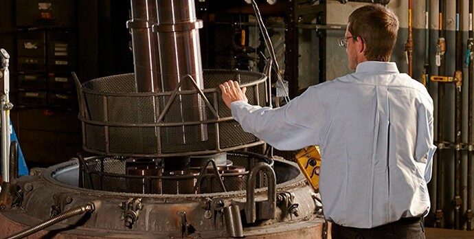

“A case-hardening technique in use since the early 20th century, nitriding steel has been an effective lower-temperature heat treatment for work pieces longer than engineers and metallurgists fully understood it. Its appeal lies in the ability to harden a part by dissolving nitrogen into its surface without austenitizing, thus all but eliminating the risk of distortion. That opened the door for improving an ever-widening variety of parts. Its popularity grows as engineers realize the technique is effective across a broad variety of parts and industries.
Origin of nitriding steel; Metallurgist Adolph Machlet developed nitriding by accident in 1906. That year, he applied for a patent that called for replacing atmosphere air in a furnace with ammonia to avoid oxidation of steel parts. Shortly after he sent the patent application off, he noticed that treating parts in an ammonia atmosphere at elevated temperatures caused a “skin, casing, shell or coating” to develop around a piece that was extremely difficult to corrode or tarnish. Also in 1906, German metallurgist Adolph Fry led a research program during which he made the same discoveries Machlet made. He also noticed that adding alloying elements to iron heavily influenced the results of nitriding. Machlet’s patents for nitriding in the U.S. were approved in 1913 and 1914; Fry received patents in Germany for his process in 1924.
How it works; The process of nitriding steel begins by heating parts in a furnace to a relatively low temperature (between 950 and 1,100 degrees Fahrenheit, depending on a part’s intended use) compared to other heat treatment methods. At these low temperatures, the iron remains ferritic-phase changes that alter the structure of the iron do not occur. But the temperature is high enough for ammonia molecules injected into the furnace to break apart once they contact the workpiece. That breakup releases nitrogen atoms, which are soluble in iron. A compound layer of nitrogen and iron forms at the part’s surface, creating the case that improves a part’s hardness and toughness.
One benefit of nitriding steel as opposed to using other heat treatments is that modern nitriding equipment allows for the precise injection of ammonia to achieve varying case depths. Another is that parts are free cooled rather than cooled rapidly via quenching, a process that further limits the risk of distortion. The precision of the process is such that parts’ intended qualities are achieved in a single step; they do not need to be softened down to specifications via tempering.
