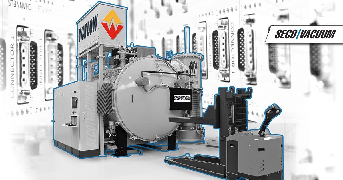

Watlow Electric Manufacturing Company, who will celebrate its centennial in 2022, has ordered – from SECO/VACUUM, a high-vacuum Vector® furnace and auxiliaries for its facility in Mexico.
The furnace will be used for annealing thermocouple wires between every drawing stage. High purity is important in order to maintain perfect surface quality of the wire and this Vector HPGQ 6-bar furnace is the optimal solution for the task. The Vector® furnace for this application has a working zone size of 40”x40”x48” (1,000×1,000×1,200mm) with a 1.5 ton load capacity. The furnace package includes a 20,000 l/s diffusion pump for high vacuum operation as well as a closed loop water system, loading cart and nitrogen reservoir. It will be capable of high pressure gas quenching with Nitrogen up to 6 bar.
The furnace was customized with an oversized work zone since the standard 36”x36”x48” zone size was too small for their needs. Some degree of customization is often requested of SECO/VACUUM since it is one of the known strengths of the company. With a very large installed base and a vertically integrated global engineering and manufacturing plant in Europe, SECO/WARWICK has the depth and capabilities to deliver on a wide range of customer needs with efficiency and dependability.
