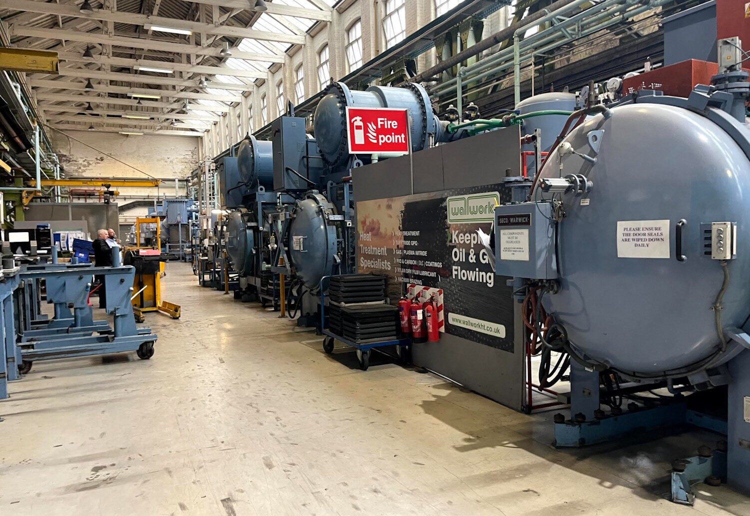

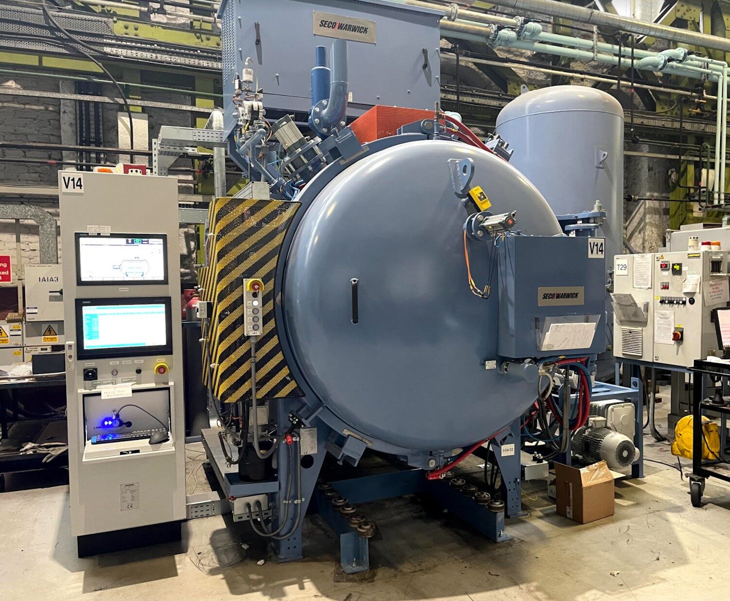

Remember the June 2021 press release below from commercial heat treater Wallwork Heat Treatment in Bury, UK? Well part of "The Monty Heat Treat News" team had the chance to look at the furnace last week and we have these images.

In addition to hardening, precisely controlled heat treatment of components in the new vacuum carburise furnace will impart many improvements to the metal wear parts so they stand the stresses of continual high speed performance. In a typical process cycle, the metal surface will become free of oxide. This eliminates initial surface wear and enhances resistance to micro cracking which also increases fatigue resistance. Equally important to improving fatigue resistance, is the elimination of oxidation at a granular level, known as inter granular attack.
Many machined components will feature holes. Here the vacuum carburise furnace delivers excellent penetration by pulsing the gas pressure so fresh gas enters the holes frequently throughout the process cycle, ensuring more evenly applied heat treatment for the component.
Advanced machining methods make motor sport components to extremely fine tolerances. Any heat treatment process can cause component distortion, especially as the part is quenched (cooled), the new furnace excels at controlled cooling. As the process takes place in a vacuum chamber the component finish is excellent and takes less time due to the ability to apply higher carburising temperatures. Another time saving benefit is the elimination of the need for component post process cleaning.
Once the correct hardness profile for a metal part has been achieved, it can be stored and reproduced by the furnace to ensure future consistency and quality. Wallwork in-house experts can even help component designers at the design stage. Discussing with the heat treater what properties they need from their component can influence the design so the gains made at the heat treating stage are even greater.
