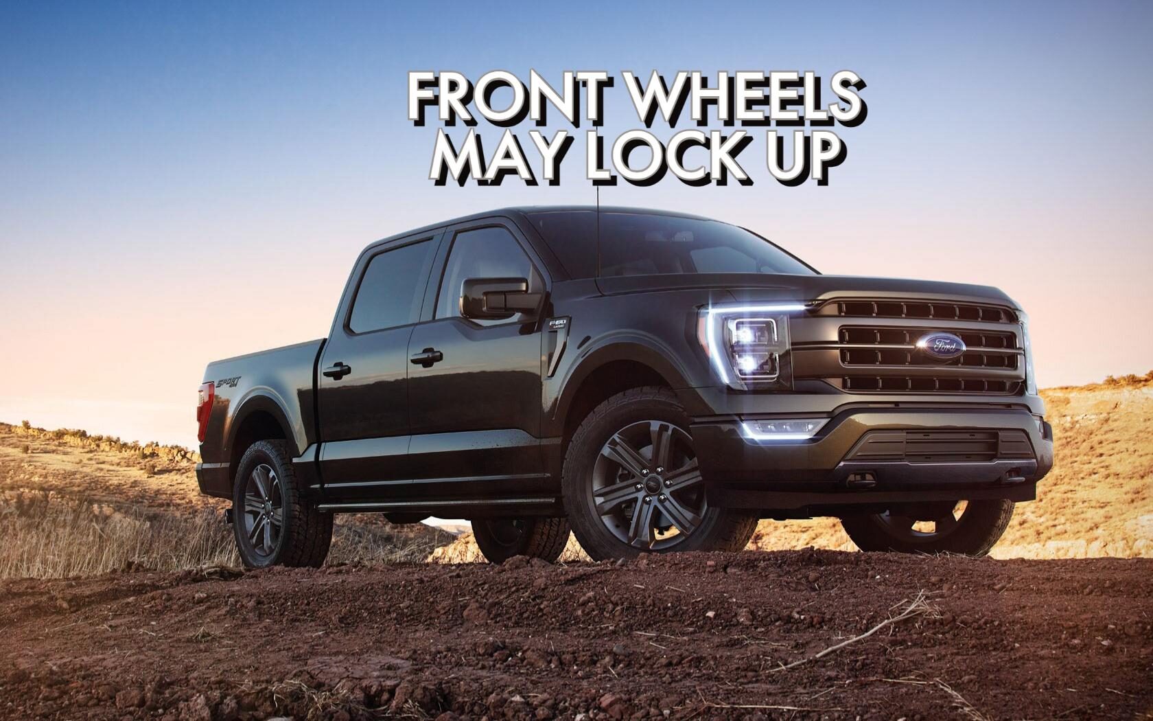

“Ford’s quality control appears to be getting worse. The Dearborn-based automaker somehow forgot to anneal the front axle pinions that equip certain F-150, Expedition, and Lincoln Navigator vehicles. By not receiving the proper heat treatment, said pinions are prone to fracture, resulting in the sudden loss of 4×4.
The abrupt switch from 4×4 to 2×4 isn’t a biggie from the standpoint of safety, but if the front axle pinion does fracture, the front wheels may lock up. Loud noises may be heard as the drive shaft and flange hit the cross member and stability bar after the pinion goes kaput.
