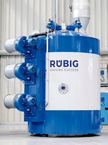

“As the engineering and manufacturing supply chains emerge from the pandemic, plasma nitriding is again in significant demand for the heat treatment of new and replacement components. Responding, Wallwork Group are upping capacity with the addition this year of two further Rübig plasma nitriding furnaces, the first due for August.
Wallwork director, Simeon Collins, explained, “This is a further £650K investment by the group, this time in our Cambridge plasma nitriding centre, increasing the existing capacity to six operational plasma nitriders, providing 24/7 processing. We are also adding a new dedicated area for inspection of case depth, structure and other quality aspects of the nitriding process.”
The Rübig furnace range chosen is the Micropuls Everest. This plasma nitrider offers several advantages, including three heating and cooling zones with the temperature measured directly at the component. A blast chiller shortens process times, while optimised filling and increased energy efficiency reduce running costs.
