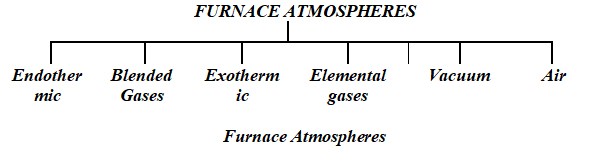

Process Troubleshooting
Protective atmospheres for heat treatment shops (captive or commercial) can fall into five categories:
