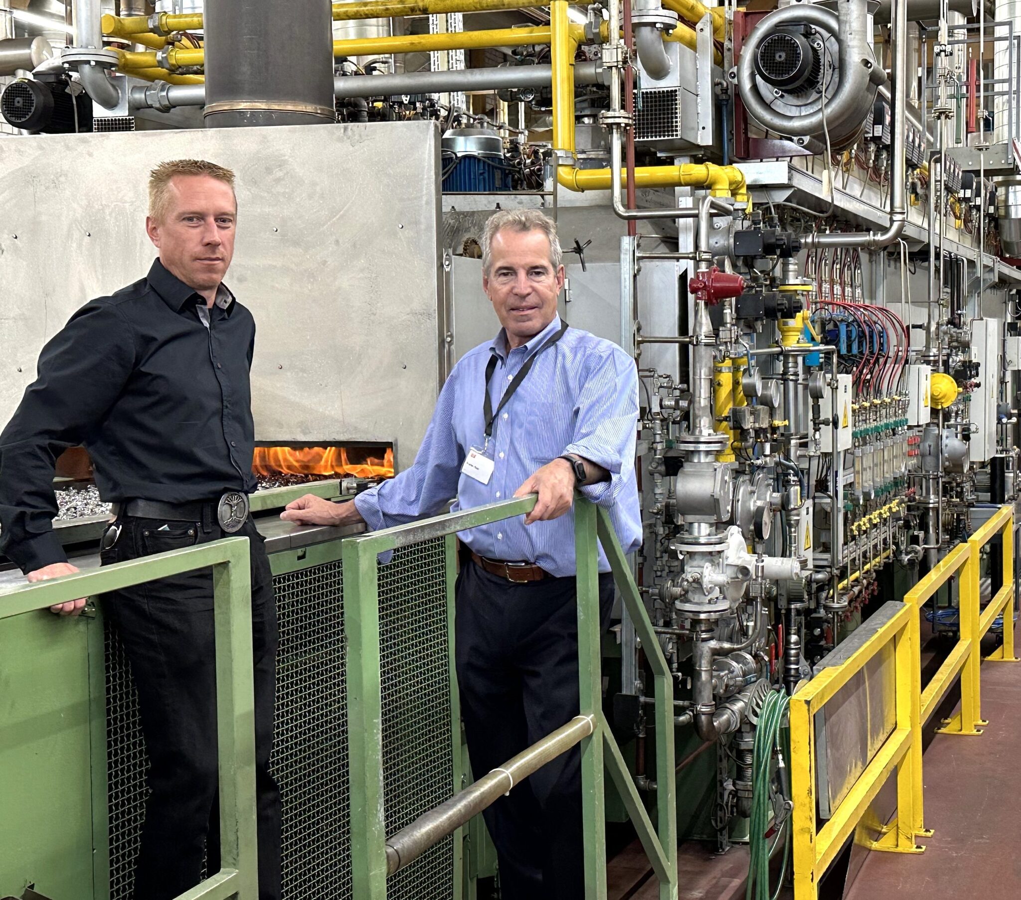

We mentioned “state of the art” equipment-there is not a single furnace in the heat treat department older than 15 years, with the bulk of the equipment being purchased within the last 5 years. Cleanliness? We leave it to these photos to tell the story.
Our host for the tour were two very experienced, knowledgeable and very friendly individuals, Harald Meier, Project Manager Heat Treatment Aerospace and Björn Penz, Project Manager Research and Development, T-RD Materials & Heat Treatment who are seen in these photos. We thank them for their time and hospitality.

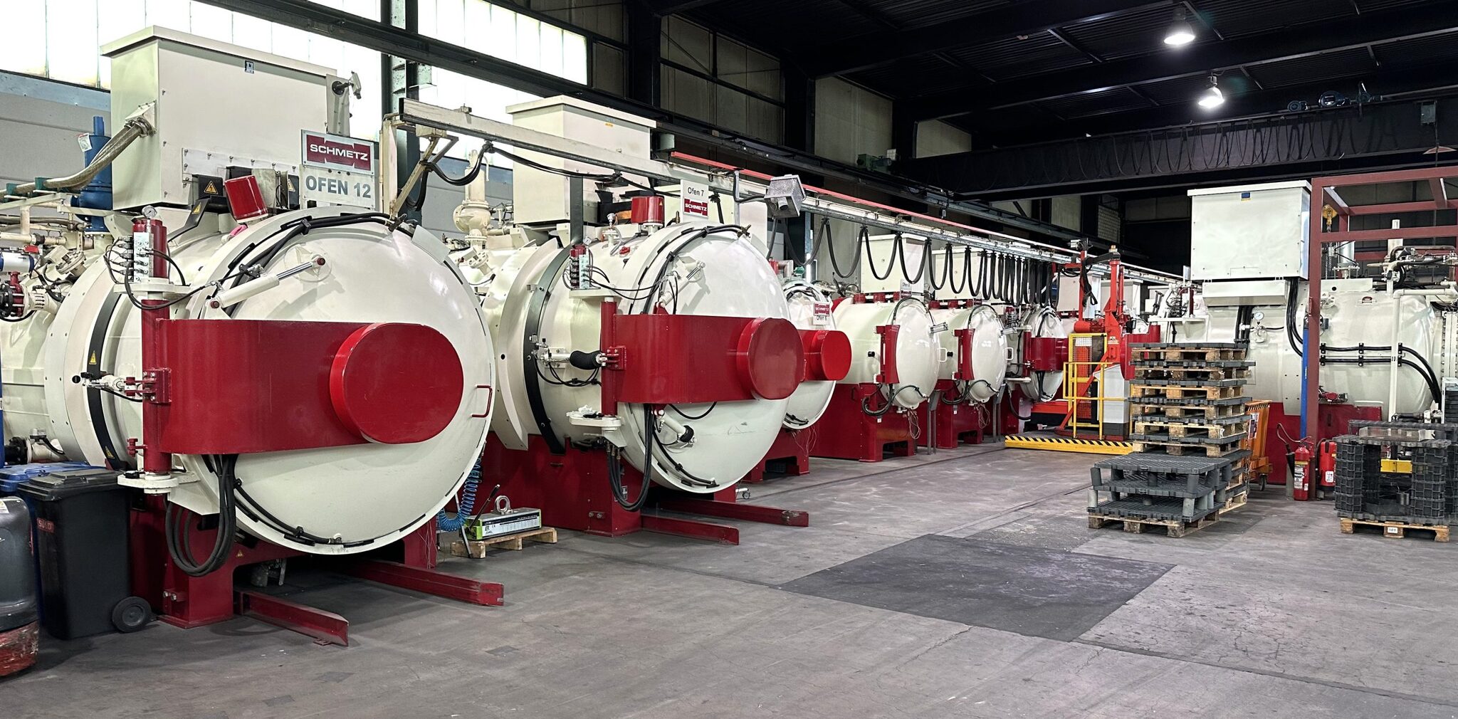

A division of Swiss Steel Group the firm has two locations, this one and a second one just down the road in Stuttgart which between them have a total of 70 employees. The facility we visited has a total of 13 vacuum furnaces, all with 10 bar quenching, two plasma nitriding systems, a number of units for case hardening along with systems for vacuum nitriding along with some water quenching units.
It is quite a sight to walk into this facility and see a total of 13 quite new vacuum furnaces all in a line, we would be overstating it to say “breathtaking” but we can truthfully say it is a sight which any vacuum heat treater will appreciate.
