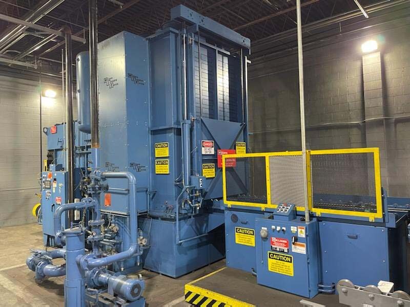

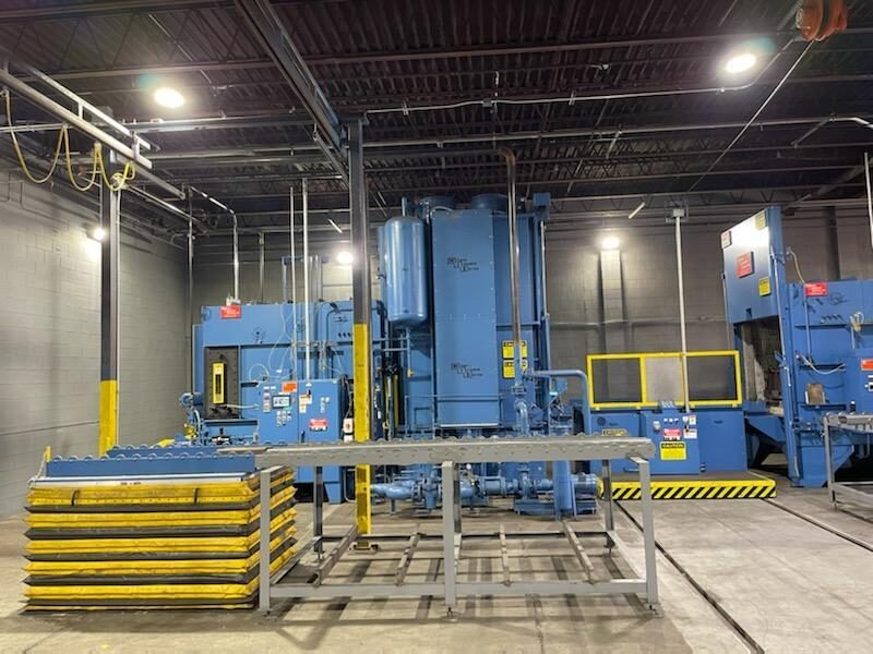

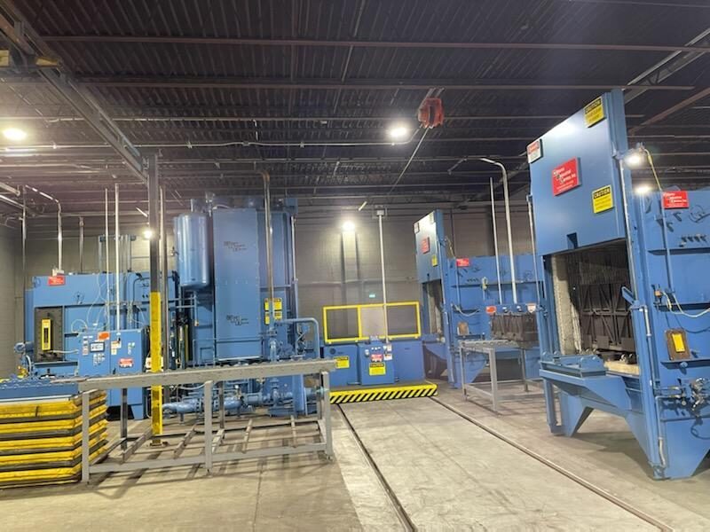

Partnering with Gasbarre Thermal Processing Systems, ThermTech has significantly increased their normalizing, annealing, stress relieving, tempering, and neutral hardening capacity through the acquisition of three new furnaces. These furnaces are now fully operational and represent over $1M in investments.
  1. The first, is a dual zone, direct-fired box austenitizing furnace, with dual load zones of 60″Wx60″Lx60″H and an AMS2750 Class 5 certified operating range of 1400°F to 2200°F. This furnace has a load capacity of 15,000 lbs and, when combined with their flexible large batch quenching capabilities, has greatly increased ThermTech’s service for customers.
  2. As a compliment to this furnace, the company has also acquired a large batch tempering furnace that has an AMS2750 Class 2 compliant certified working zone of 140″L x 60″D x 60″H with a certified operating range of 300°F-1350°F.
  3. Finally, ThermTech has increased the throughput of their large batch integral quench furnace line with an additional tempering furnace. This furnace is 54″W x 72″L x 72″H and is also AMS2750 Class 2 compliant from 300°F-1350°F.
