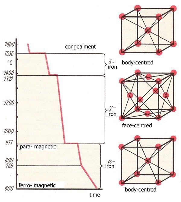

At Room Temperature the Iron exists in a 9-atom structure which is one on each corner and one located in the centre of the cube. This is known as a Body Cantered Cubic Lattice and will exist in this form up to approximately 720°C.  as shown below.
This Illustration below displays the phase changes that occur in the Iron.
As you can observe the are three distinctive phase transformation occurrences. It should also be noted (as a very important observation) that each of the phases have a different volumetric size change. This simply means, that no matter what or how you heat up the iron, there WILL BE a size change. You have NO CONTROL over that phenomena.

Ferrite is an area below the lower critical line of the Iron Constitution diagram and has a magnetic property.  It comprises 9 atoms and is a BCC. (Body Cantered Cubic Lattice structure)

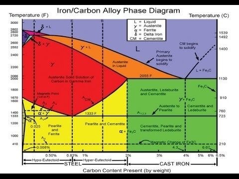

The following illustration shows the Iron Carbon Equilibrium Diagram. (Please be aware, that the diagram does not consider the addition of various alloys, only Iron and Carbon. For simplicity, one can make an equilibrium diagram with ordinary waters plus salt and noting the freezing point and boing point with different additions of salt into the water.)
Hypo-eutectoid steels: Steels having less than 0.8% carbon are called hypo-eutectoid steels (hypo means “less than”).  Consider the cooling of a typical hypo-eutectoid alloy along line y-y‘.
At high temperatures the material is entirely austenite. Upon cooling it enters a region where the stable phases are ferrite and austenite. The low-carbon ferrite nucleates and grows, leaving the remaining austenite richer in carbon. Hyper-eutectoid steels (hyper means “greater than”) are those that contain more than the eutectoid amount of Carbon.
The Eutectoid line is that vertical line that separates hypo from hyper. It is generally found at a point of 0.77% on the horizontal carbon axis line. When such a steel cools, as along line z-z’ , the process is similar to the hypo-eutectoid steel, except that the primary or pro-eutectoid phase is now cementite instead of ferrite.
Various phases that appear on the Iron-Carbon equilibrium phase diagram are as under:
  • Austenite
  • Ferrite
  • Pearlite/Cementite
  • Martensite
