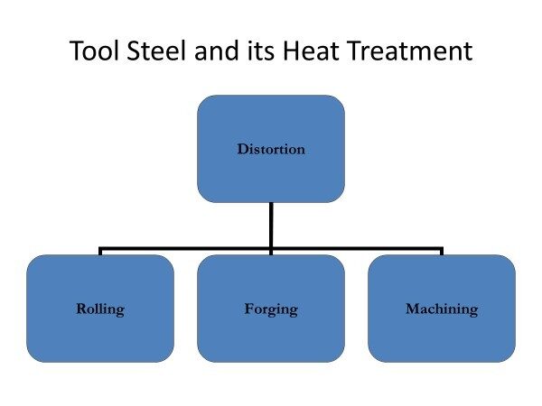

Any time that steel is worked, either by forging, rolling or machining the induced surface stresses are set up in the steel. The only effective manner in which the induced stress will receive itself is by the application of heat.
![](https://themonty.com/wp-content/uploads/2019/10/a.jpg)
So it can be seen that distortion is not necessarily caused by the heat treater, but by the aggressiveness in which it is machinated. Another myth is that hard turning will reduce distortion because of the speed of the cut. The faster you cut, the greater the friction generated and the greater the risk is of forming untempered martensite on the steel surface. Untempered martensite will lead to the potential for surface cracking.

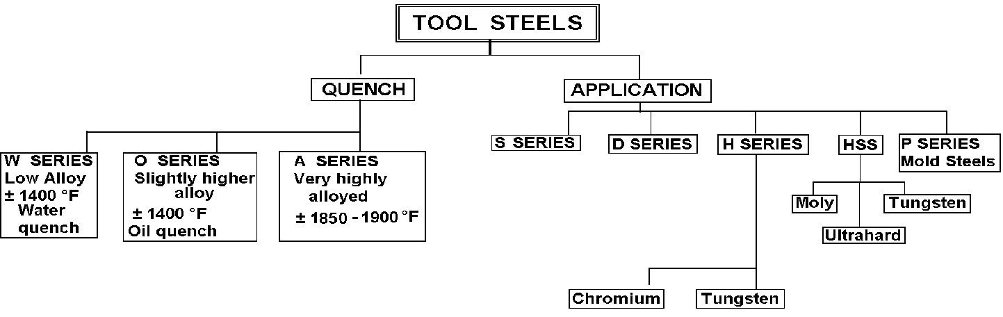

Suggested pre-heat and selection of the cooling rate for the appropriate mechanical and metallurgical properties. The following illustration shows the categorization of the tool steels. Further, it should also be remembered that the metallurgy of the tool steels is still based on the metallurgical principles that were discussed in the first courses. We still need to heat soak and cool, according to the metallurgy required for the tool steel to function.

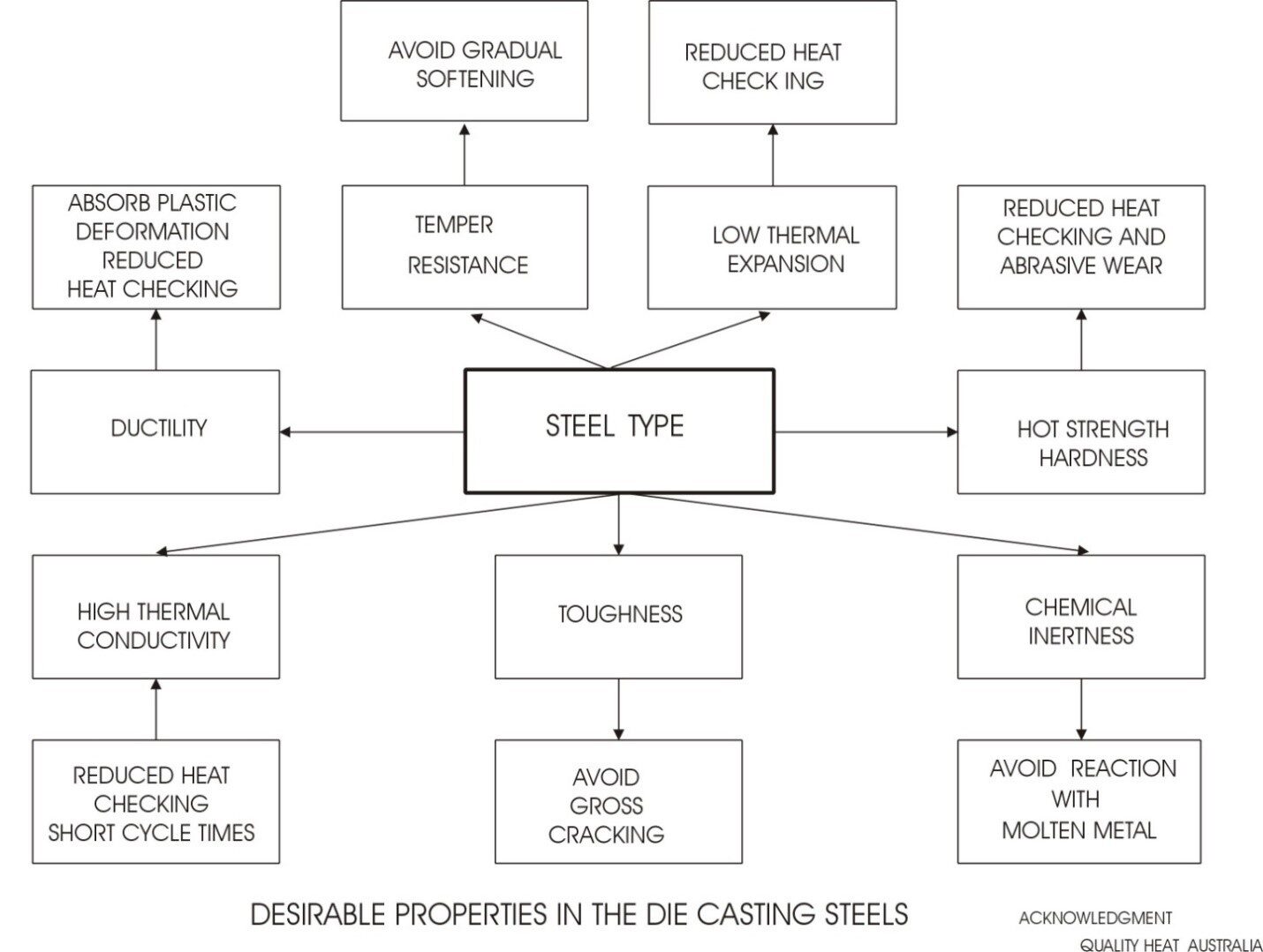

The next illustration demonstrates the principle property requirements necessary in a steel to be used for example for die-casting operations. The steel box in the center of the illustration will be determined by whatever properties are required of that particular steel. It will be as a result of the heat treatment procedure that will determine if the steel will fulfill all of the requirements that are necessary.
Tool steels hold a special place in most branches of engineering as they are used to: form, shape, roll, extrude, bend, cut, shear, and mold. Each of the above will place many different demands on the steel to perform successfully in different environments. Tool steels are usually made in small lots by specialized steel makers. The steel recipe is very carefully controlled to ensure high quality and high cleanliness.
