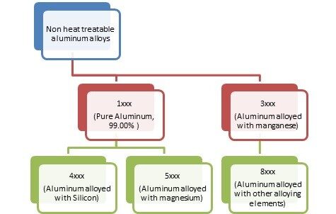

This short presentation will deal with the categorization of the heat treatable alloys and followed by the introduction of the thermal strengthening procedures of heat treatable aluminum alloys. Although there are many alloying elements that can be added to the basic aluminum, there are generally only 5(five) major alloying elements. The alloying elements for aluminum are seen in the illustration below;
Categorization of Non Heat Treatable Aluminum Alloys
The only thermal treatment that can be given to the non-heat treatable aluminum alloys are those thermal treatments that will; Anneal,     Stress Relieve. There are no other thermal strengthening treatments that can be applied to the non-heat treatable aluminum alloys.

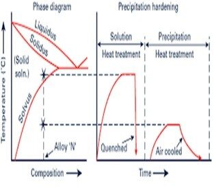

Solutionizing Treatment. (sometimes known as solution anneal)
Precipitation treatment. (age hardening/naturally/artificially. The net result of the solutionize treatment (in terms of hardness is, that the particular alloy is in its softest condition). The precipitation treatment is the process that will develop both the appropriate metallurgy and the mechanical properties of the particular grade being treated.
Solutionize Treatment. There is a very specific reason for the solutionizing procedure which is to take into solution (dissolve) all of the principle alloying elements contained in the analysis of the aluminum alloy. The alloying elements are known as the solute elements. The solute elements are generally;

The process of aluminium solutionizing treatment is slightly different to that of steel heat treatment. It is different in so much as the solution as treatment which involves heating the aluminium alloy up to its appropriate solution temperature followed by quenching rapidly, this makes the alloy extremely soft. This procedure is done simply to make sure that all of the solute alloy elements go into solution. (Hence the name solutionizing.) (Think now of the saturated solution of salt in water, the method of making the salt go into solution is to raise its temperature);
The next illustration shows a typical solutionize procedure, followed by a precipitation hardening procedure:
The process temperature is such, that the aluminum alloy is very close to the aluminum alloys lowest melting temperature, which necessitates the need for;
  • Temperature accuracy
  • Temperature uniformity
In addition to this requirement, it further necessitates the ramp up to the solutionize temperature as uniformly as is possible to reduce the risk of creating low temperature grain boundary melting and for the possible cause of segregated structures. The time at the solutionize temperature will be determined if the heat treatable aluminum alloy will be;
