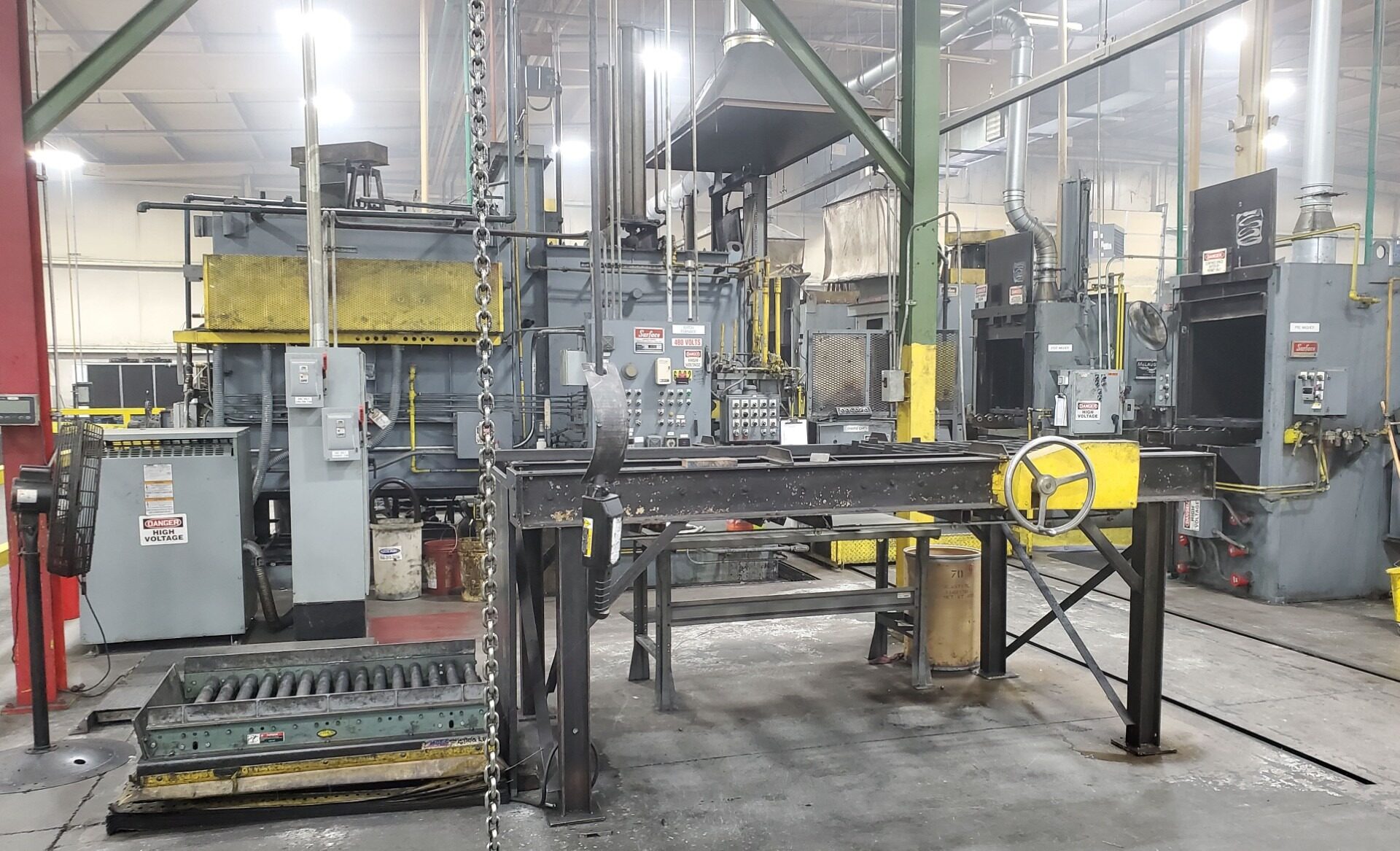

So in summary while a gas fired “Super 30” in reasonable condition can generally find a buyer, an electrically heated unit is not a popular item on the used furnace market and sale prices reflect this. (The attached photo shows a typical older, electrically heated “Super 30”).
