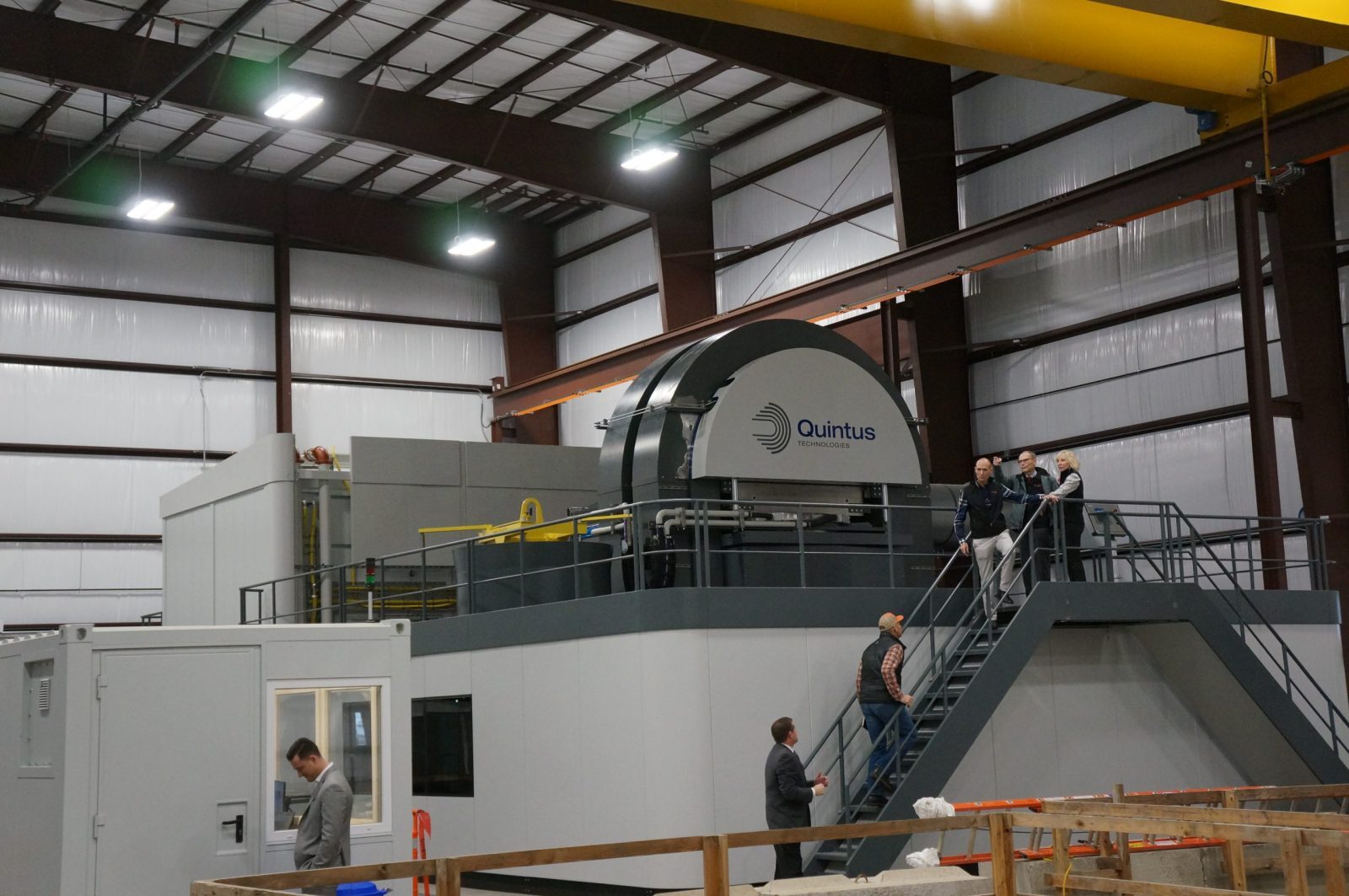

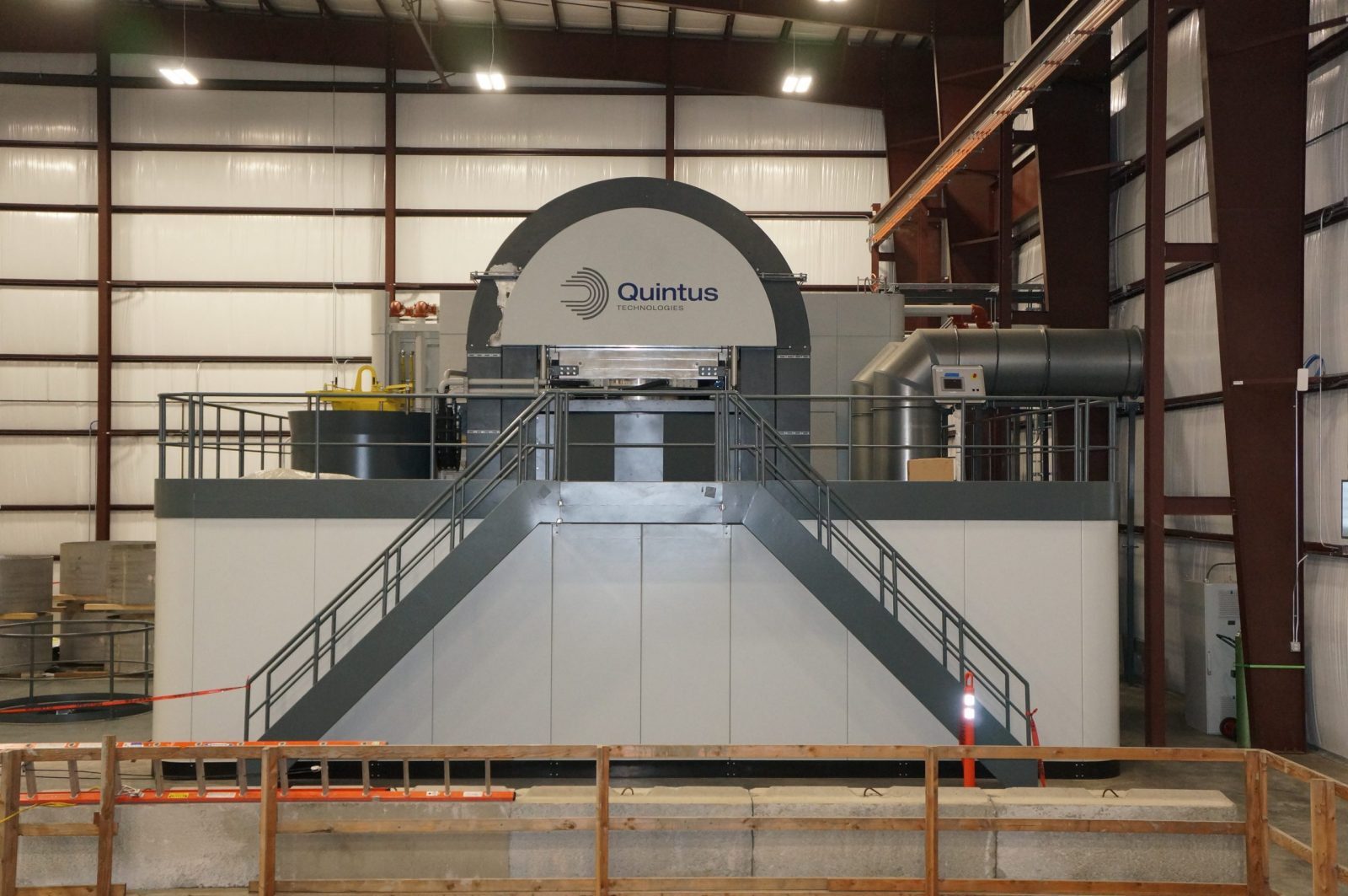

January 27th, 2020 saw the Grand Opening of the Stack HIP (Hot Isostatic Press) facility in Albany, Oregon, USA (all the details about Stack’s investment in this technology can be found in the press releases below). It truly is an impressive operation as can be see in the pictures below and we can say that they don’t really give you an idea about how large the system is. How about we phrase this another one which really should get your attention, the HIP unit cost approximately $18 million USD and total investment in this plant will be about $25 million USD-now those are really impressive numbers! To refresh your memory these are the details about the unit; “The Hot Isostatic Press, model QIH286 M URC®, is equipped with Quintus’ proprietary uniform rapid cooling and features a large-capacity work zone of 63 inches (1,600 mm) in diameter and 102 inches (2,591 mm) in height, allowing densification of large batches at 29,000 psi (2,000 bar) and a maximum operating temperature of 2280°F (1,250°C). The QIH286 Mega-HIP satisfies Stack’s demanding criteria for output quality, operational performance, and cost-effectiveness.”
