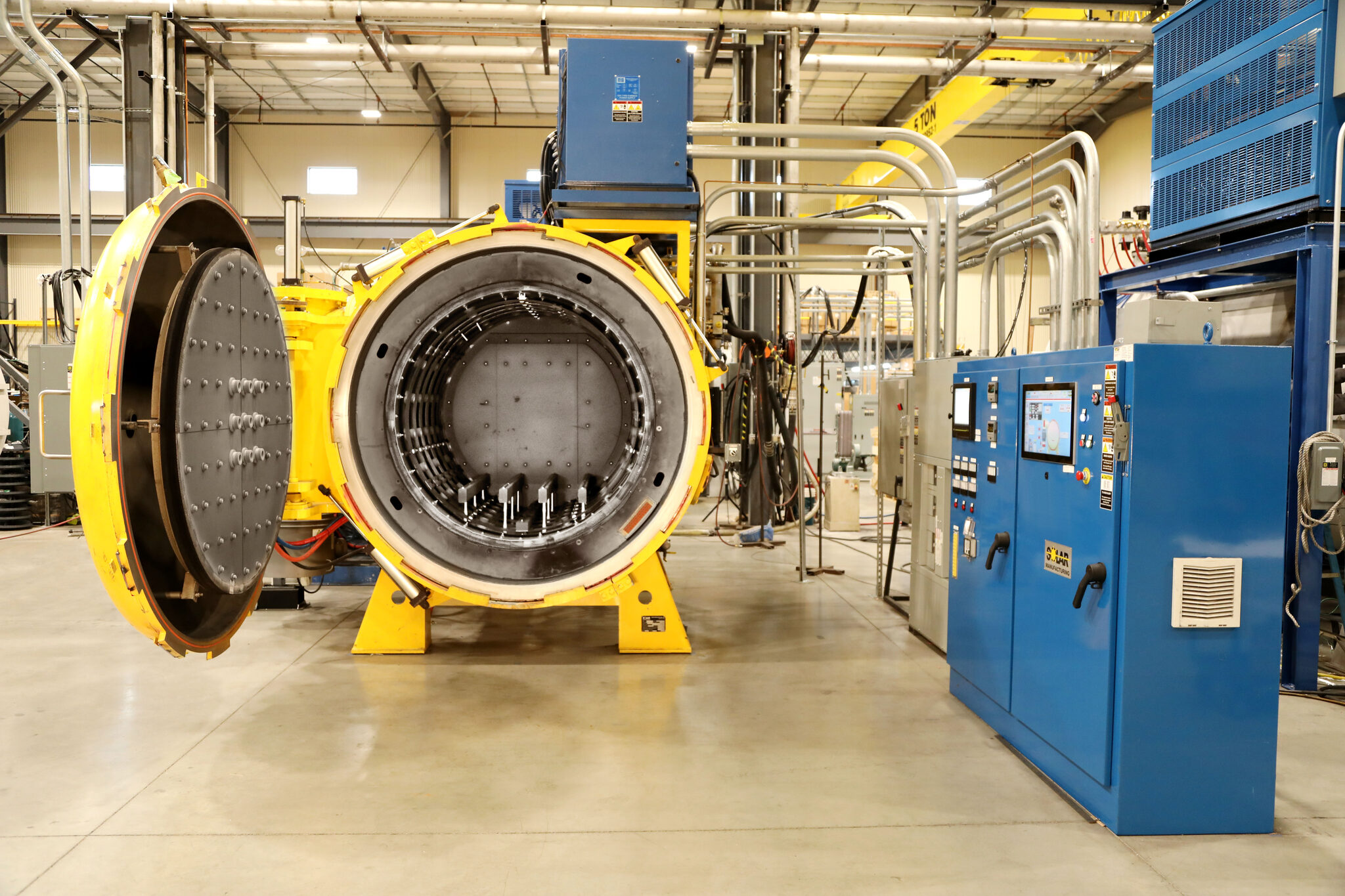

“Solar Manufacturing Inc. announces the receipt of a vacuum heat treating furnace order for a firearms manufacturer based in the United States. The furnace, Model HFL-5748-2IQ, has a hot zone of 36” x 36” x 48” deep with a weight capacity of 5,000 lbs., and maximum operating temperature of 2400°F, and heats to 2500°F for hot zone bake out. The furnace design also has a temperature uniformity of ±10°F and is AMS2750 compliant with vacuum levels in the low micron range.
For rapid turnaround for work cooling, a 100 HP gas blower is provided for operating at 15 PSIG (2–bar) in nitrogen gas. The furnace is complete with a SolarVac® Polaris fully automated and programmable industrial controls package, and a Eurotherm digital chart recorder.
The system also includes a Magnetic Specialties, Inc. (magspecinc.com) SCR–based dry power supply rated at 225 kVa.
