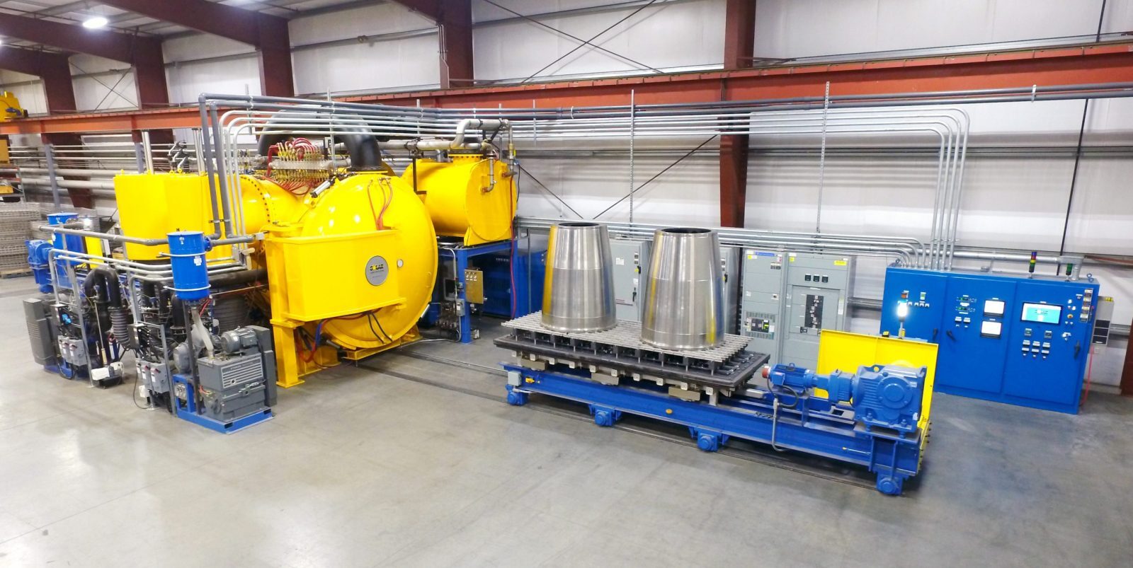

“Solar Atmospheres of California (SCA) recently added additional large furnace capacity to their already extensive inventory of vacuum equipment. The furnace was specifically designed to process a variety of materials that require optimum performance during controlled heating, controlled cooling, vacuum processing, positive pressure processing, and differential pressure processing. SCA works very closely with sister company, Solar Manufacturing, to design and fabricate equipment to provide repeatable mistake-proof processing while meeting all prime requirements and AMS 2750. Key equipment performance characteristics include:
• 84” diameter x 144” long, robust and energy efficient all graphite and CFC hot zone
• Temperature uniformity ±10°F
• Dual 35” diffusion pumping systems capable mid 10-6 Torr range
• Maximum operating temperature of 2650°F
• Maximum loading of 50,000 lbs.
• 2–Bar high performance 800 HP cooling system (Argon, Nitrogen & Helium)
• SolarVac Polaris® Electrical Control System
