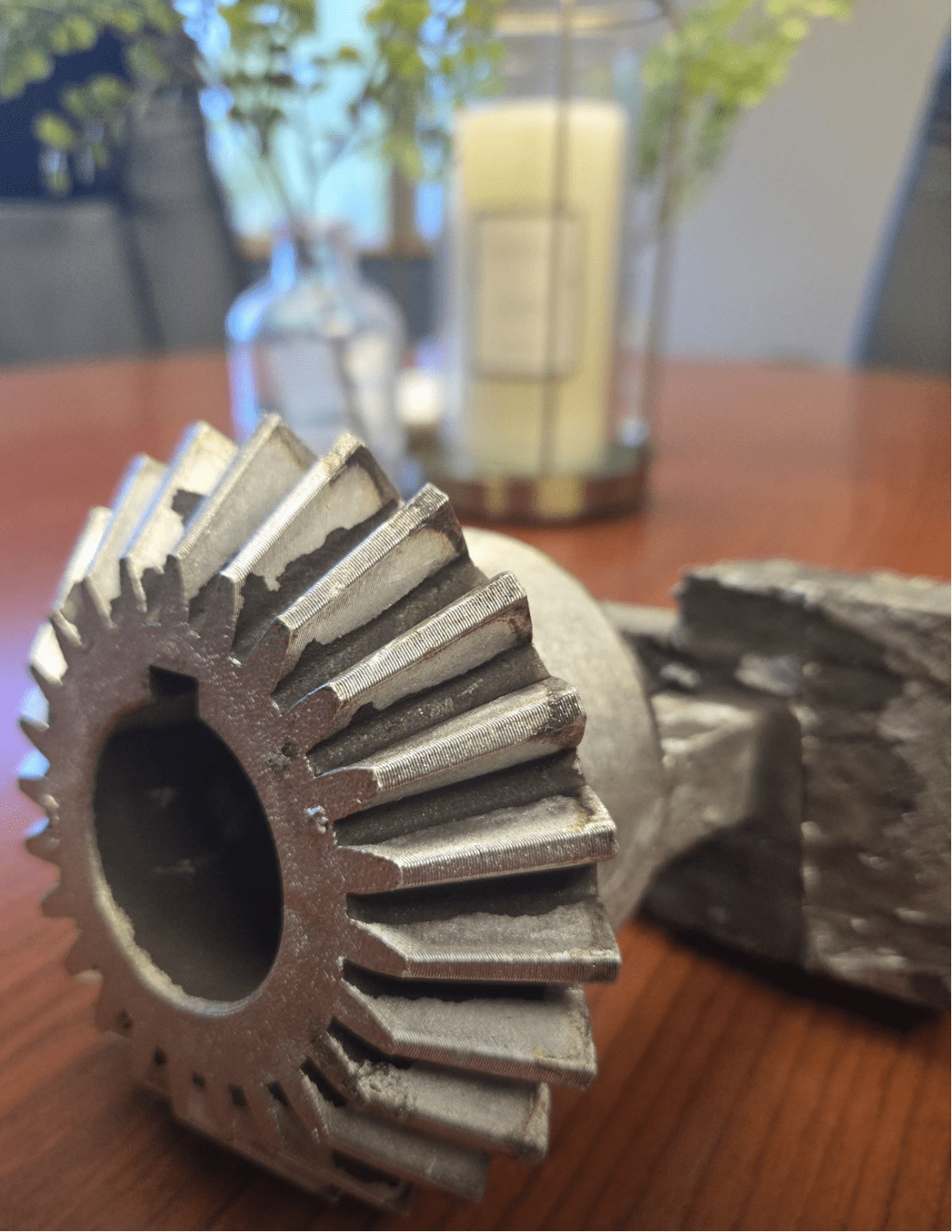

See an example of a part we’ve regularly cast in 6061. Regarding things that may be of interest for the average heat treater, first the development of cast alloys that are wrought will likely require new heat treat recipes since the base material is not the same starting microstructure. Second, since we have developed the ability to lost foam cast steel, we are doing a lot of work in casting steels including getting into casting heat treat equipment alloys like HU, HK, etc. The AMEC process can also be used to make these without tooling such as for spares.
