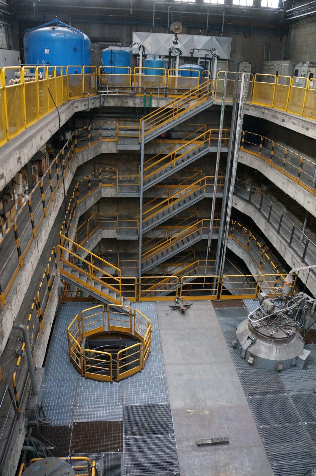

Unfortunately we don’t have a good picture to go with this SECO press release so we are including a photo “The Monty” team took in Italy two years ago showing the largest pit nitriding furnaces we have seen anywhere in the world. As a matter of fact when NASA was processing parts for the Saturn rocket program a number of years back these were the furnaces used to treat the parts as they were unable to find a source in North America.
