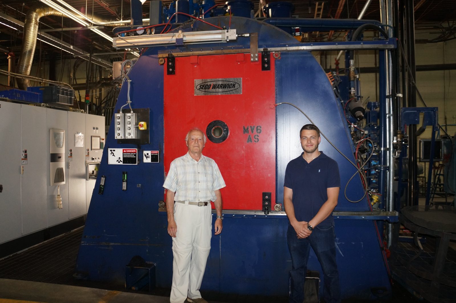

Furnace builder SECO/WARWICK issued this press release about recently delivering two CaseMaster vacuum furnaces. To add to this news item we are including this photo of Jordan Montgomery of “The Monty” standing in front of a CaseMaster furnace which is installed and in operation in North America.
