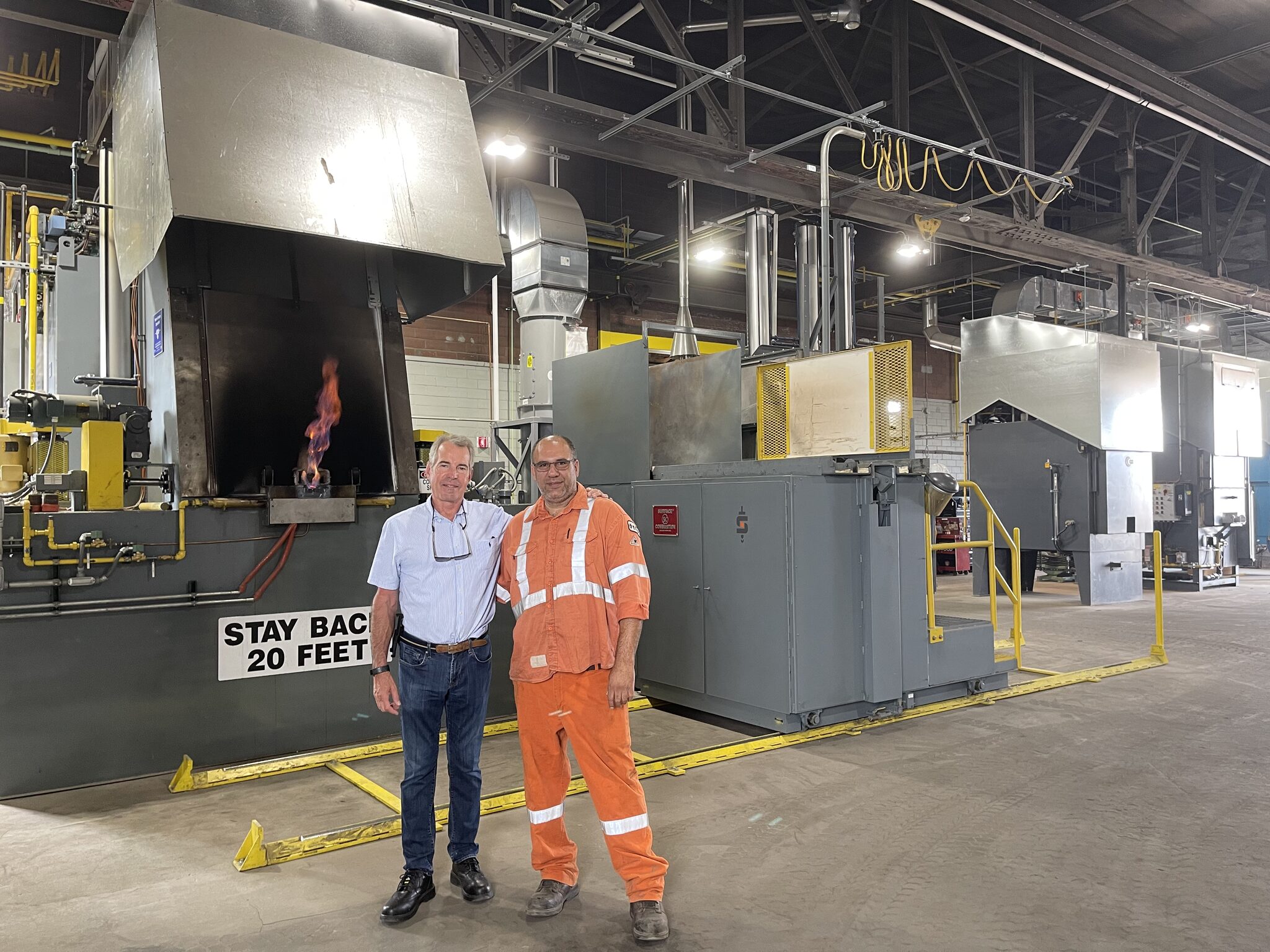

Located in an industrial park, Salto employs eight people, including Mehanna; six are on the shop floor and two are in the office. It has 24,000 sq. ft. of floor space that has been meticulously designed with eight furnaces, including the shop’s custom-built, fully automated Integral Quench (IQ) line.
“It was very important for us to go after the latest technology to be able to provide the best production and quality standards that our customers have come to expect from us,” said Mehanna. “Felix was adamant that we have the best equipment with the latest technology. That’s why we decided to custom build our furnaces rather than just buy what was available on the market.”
The shop was able to custom build its IQ line in part because of the team’s extensive heat-treating experience.
Accuracy and uniformity are essential for good heat-treating practices and having equipment that could perform both to a high degree was necessary. The IQ line is highly automated and includes digital equipment and controllers. To meet surface smoothness requirements, the shop added probes and pyrometers inside the furnace to monitor the temperatures.
“The advantage of going digital is that we can remotely monitor everything about the system,” said Mehanna. “If there’s any error, the burner goes down, or the furnace troubleshoots, I get notifications on my phone. We couldn’t do that with some of the other equipment on the market. I can receive emails updating me about our furnaces and I can fix or troubleshoot right from my laptop. I can have our automation engineers go in and fix any problems rather than having to go onto the shop floor in many cases, which makes fixes much quicker and more efficient.”
Mehanna and his team spent over a year on the road looking for equipment, planning, and designing a fully automated, state-of-the-art heat-treating facility.
