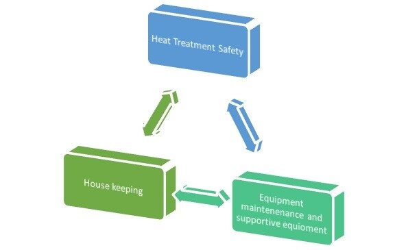

Safety in heat Treatment touches each and every one who works in either a captive or a commercial heat treatment shop. We all have a responsibility to each other to minimize the risk of accidents and injuries (no matter how minimal or extensive that injury might be). The two area’s that this presentation will address are shown below;
Housekeeping

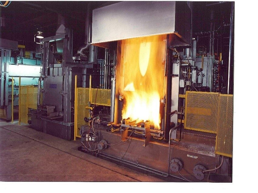

Quite a large number of both captive and commercial plants have as their processing equipment, the integral quench furnace. That are used for atmosphere heat treatment procedures such as Carburizing, Carbonitriding, and neutral hardening procedures. The furnaces are more often than not, filled with combustible atmospheres as well an internal quench tank of specialty quench oil.
Shown below is an integral quench furnace. Once the furnace is gassed up, it can be likened to a ‘fire breathing dragon’ once the furnace is gassed up. The atmosphere concern and consideration apply also to continuous furnace systems, shaker hearth furnaces, 2 to 4 row pusher furnaces
Fig 1 An integral quench furnace filled with the process gas.
Fig 2.  The fire breathing Dragon!!
The safety rules are really quite simple; however, one should follow (implicitly) the furnace builder’s safety and handling of atmosphere introduction into the furnace. This will be found in the Manufacturers Operational and Maintenance manual.
  • DO NOT INTRODUCE THE COMBUSTIBLE ATMOSPHERE INTO THE FURNACE BELOW 1400°F!!!
  • Never stand directly in front of the furnace door once the furnace is gassed up with a combustible gas. If an explosion should occur there is the potential for the explosion to blow off the furnace door.
