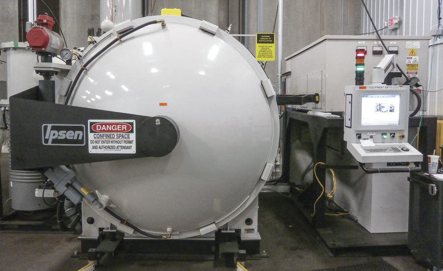

Metallurgical Thermal Treatments Under Low Pressure Conditions.
Moving away from equipment and into process technologies, vacuum heat treatment has progressed dramatically from the simple annealing forward stress relieving processes to incorporate many various surface modification processes.
For example, the deposition of an exotic metal compound onto a metal substrate or the diffusion of gaseous elements into the surface of a metal or material composition.
Some of the thermal surface treatments that are currently being process utilizing
low pressure conditions are;
  • Low-pressure carburizing. This now allows the metallurgist the ability to carburize at higher selected process temperatures for carburizing. The caution here is that the austenitizing of the carburized surface still follows the principles of careful temperature selection in order to transform the surface into a controlled martensitic form.
  • Low-pressure plasma carburizing. This procedure is still perhaps in its infancy and will most likely consume some time before it becomes a well-accepted and standard method of carburizing utilizing plasma. The unique feature of plasma carburizing is that the process gas consumption is now at a minimal utilization because the hydrocarbon process gas is only required at the surface of the component being carburized rather than necessitating the need to fill the process chamber with the hydrocarbon gas.
  • Plasma nitriding. Plasma nitriding is a low temperature process which utilizes either nitrogen-based gases such as ammonia or varying ratios of molecular nitrogen and molecular hydrogen and is now a proven and accepted method of nitriding.
  • Chemical vapor deposition. This procedure makes use of low pressure conditions to deposit to deposit onto the surface of a component, a high hardness, hard wearing metallic deposition such as titanium nitride, titanium and carbon nitride etc.
  • Physical vapor deposition. This procedure is particularly attractive because of its low operating temperature of approximately 1000°F (550°C)
Not all of the processes mentioned require a high hardness or wear resistance, some components may call for a combination of wear and corrosion resistance.
Typical applications of these procedures are generally utilized for high wear conditions, and corrosive conditions. Components that are generally seen to be utilized by these processes are cutting tools, hydraulic equipment and components that are likely to be subjected to either high wear conditions, or corrosive conditions, or a combination of high wear and corrosion resistance.
