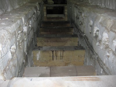

Item#C269 C.I. Hayes Mesh Belt Furnace
Working dimensions of 5″ over belt, 12” wide X 120” of heated length. Electrically heated 230/3/60, operating temperature of 2100F. Model LAC. Temperature controls are new state of the art, control panel with Honeywell sold state digital readout controller and overtemp for each of three zones, includes volt and amp meters. Full alloy muffle in hot zone. 20’ long sealed water jacketed cooling. Globar heating elements over and under the belt. (3) zones of control. (4) argon flowmeters. Dayton AC inverter provides adjustable belt speed. Updated SCR controls. Muffle and belt are new. Very good condition.
