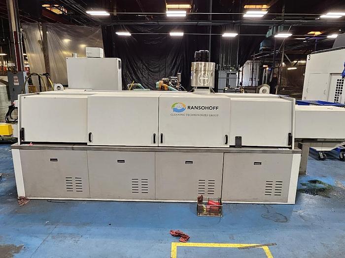

Item # W402 "Ransohoff" Conveyor Belt Washer

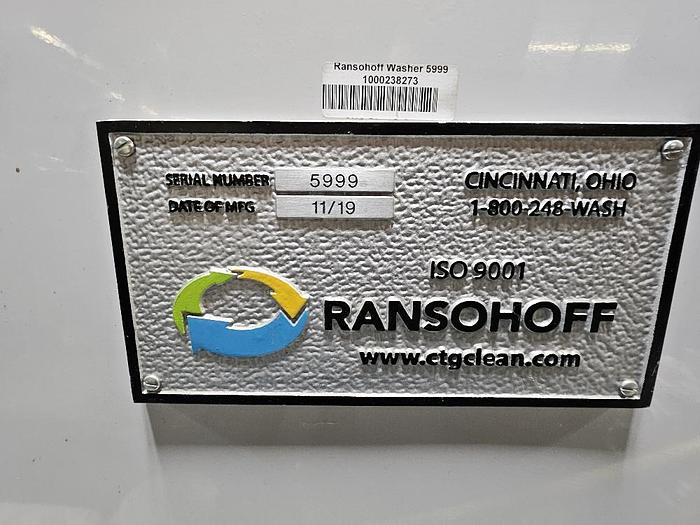

Built by "Ransohoff" in 2019 this is a SS "Leanveyor Conveyor Washer", Serial #5999. Electrically heated, 460/3/60/170 Amps. Maximum temperature 140F/140F/180F.
7" Wide Balanced Weave Conveyor Belt, 1/4" x 1/4" Flights welded approximately every 6" on center. 2-1/8" Tunnel Height
Variable Speed 1-5 FPM
Construction:
Tanks: Stainless
Housing: Stainless
Solution Piping: Stainless
Insulation: 1" Thick
EQUIPPED WITH:
(4) Sliding Access Doors
Electric Immersion heaters
Pre-Blow-Off Regenerative fan (to blow off chips prior to entering wash) Air Knives front and back, top and bottom, Includes Wheeled Chip Basket Cart.
Gusher Stainless Steel Wash Pump 7.5 HP includes wash pump screen, wash tank access lid wash bag filter, wash solution from top, bottom, and sides via stainless piping.
Gusher Stainless Steel Rinse Pump 2HP 70 GPM includes rinse pump screen, rinse tank access lid, rinse bag filter, rinse solution from top, bottom, and sides via stainless piping.
Stainless Filtermist FX-900 Stainless Mist Collector 900 CFM 3HP Motor
Marine Door Access
(4) Machine lifting lugs
Manual Unload Photo-eyes for Hi-Limit
Emergency Stop on each end.
Liquid Level Controls
Excellent condition. Asking $65,000 USD.
