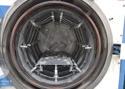

Item # VF478 2 Bar Quenching Vacuum Furnace-2400F

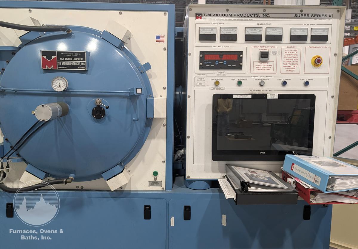

Manufactured by T-M Vacuum Products this is a Model SS12/24-18DMX vacuum furnace, Serial #1512990916
Working dimensions of 12″ Wide X 12″ High X 24″ Deep, 200 pound load
Built 2016
460/3/60/150 Amps

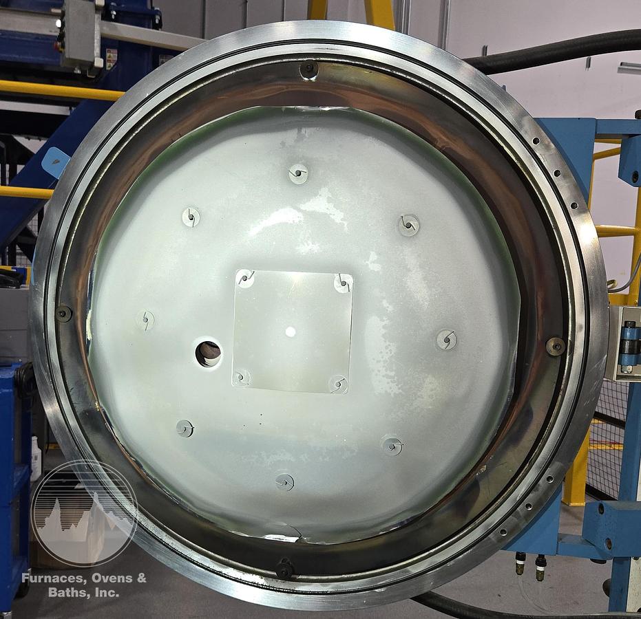

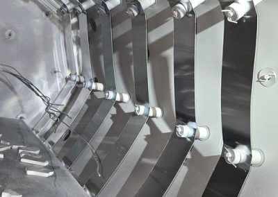

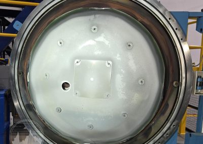

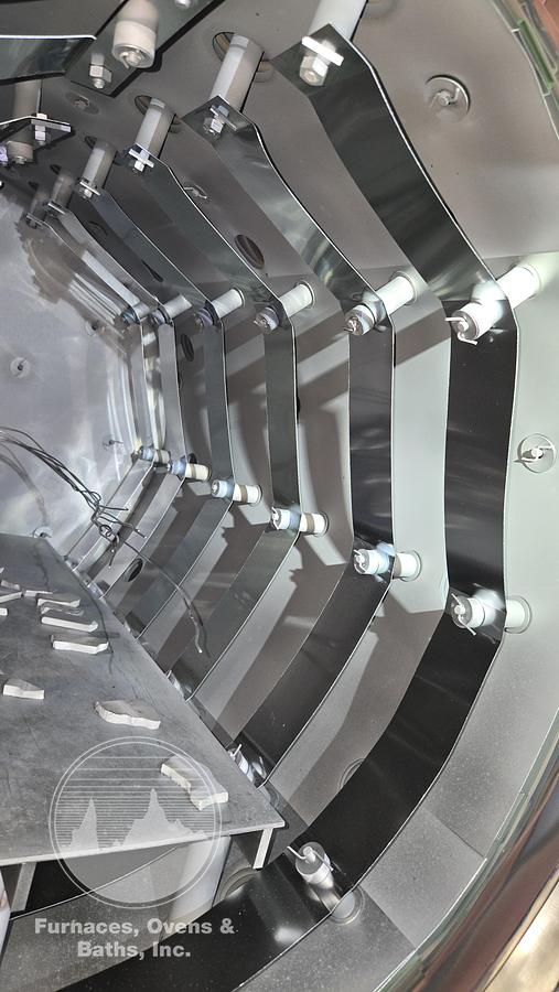

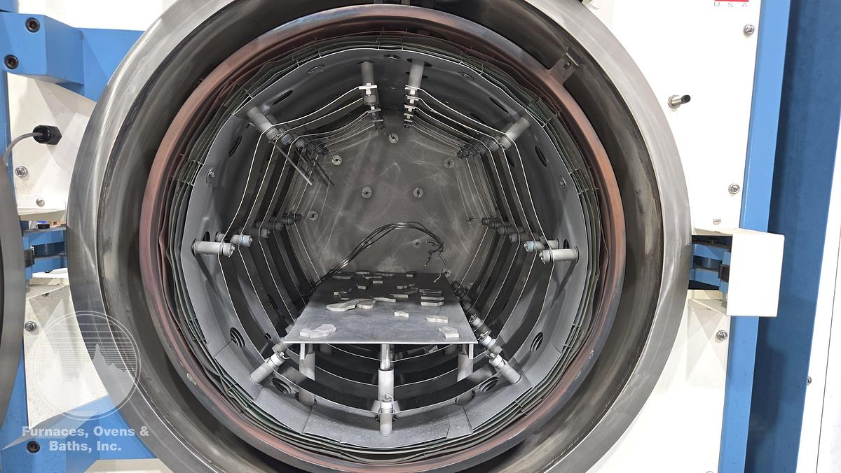

Horizontal front loading double wall vacuum furnace with stainless steel chamber. Door consists of six (6) pneumatically operated clamps for 2-Bar pressure. All metal Hot-Zone (Moly) consisting of Moly layers backed by stainless steel, 2″ Moly band type heating elements and Moly hearth assembly. Furnace is equipped with a diffusion pump, mechanical pump and holding pump. Cooling consists of a 10 HP with heat exchanger.
****** Furnace Meets AMS-2750H requirements and uniformity at 1100F (-3.8F to +2.2), 1700F (-6.7 to +2.4) and 2100F (-10.9 to +1.7) as of March 2022 when it was last tested by ATP. Tight furnace for aerospace applications. ******
Controls are mounted and wired on the self contained system and includes a Allen Bradley PLC w/HMI Interface, Partlow digital high limit, AC Amps/Volt Meters for front center and rear zones, Televac vacuum controller and Three (3) Control Concepts SCR power controllers for each zone.
