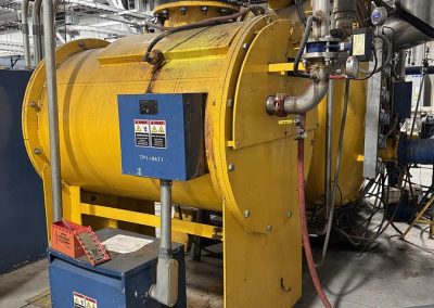

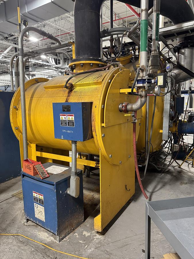

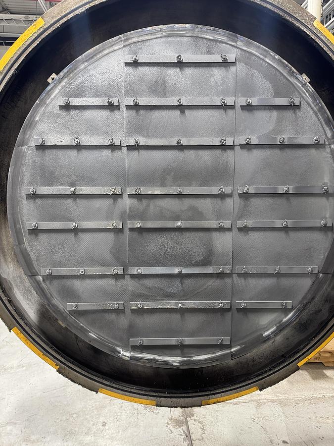

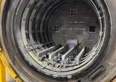

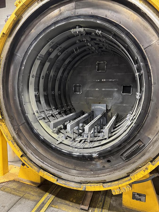

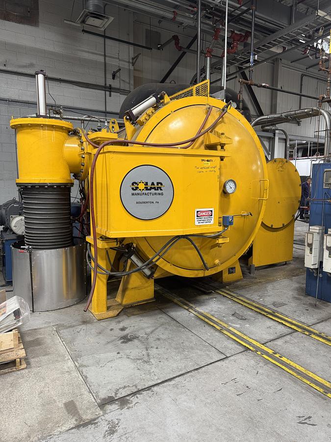

Item # VF470 Solar Atmospheres HFL-5748-2EQ Vacuum Furnace, 2850-F, 2 Bar, Diffusion Pump, NEW HOT ZONE

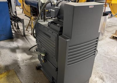

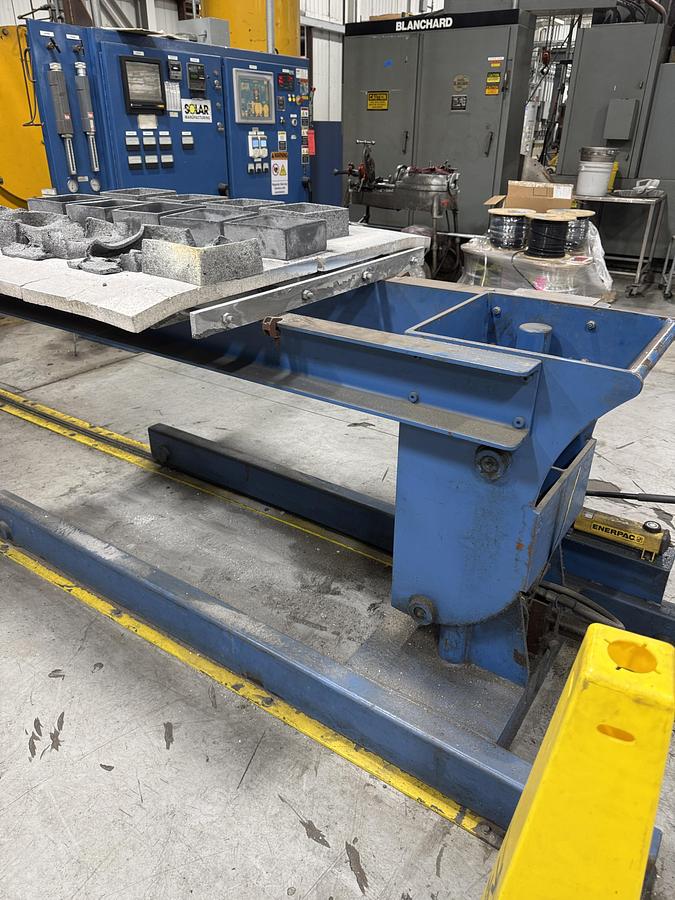

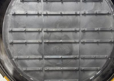

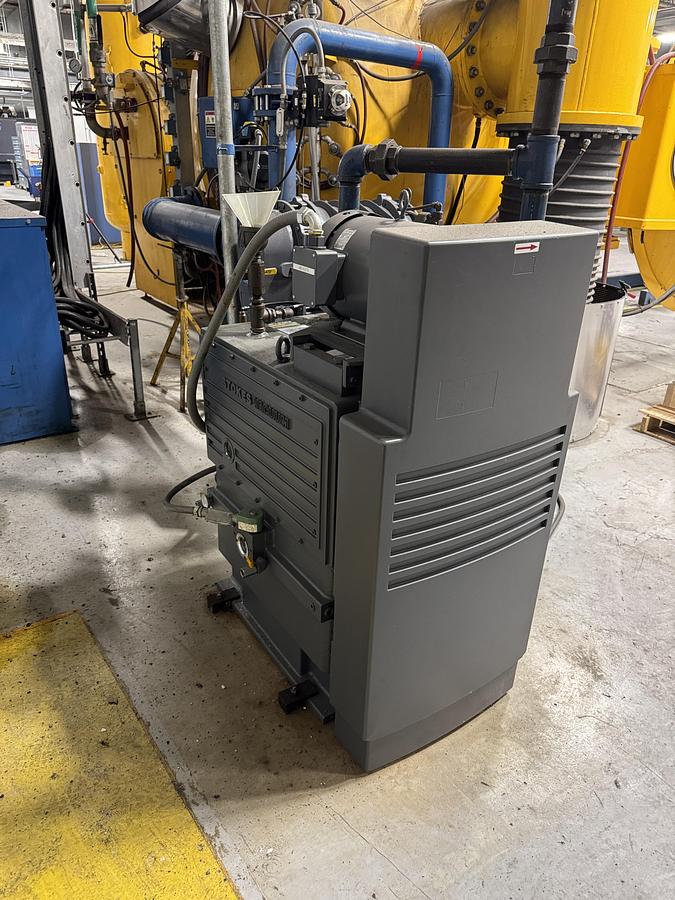

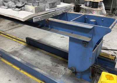

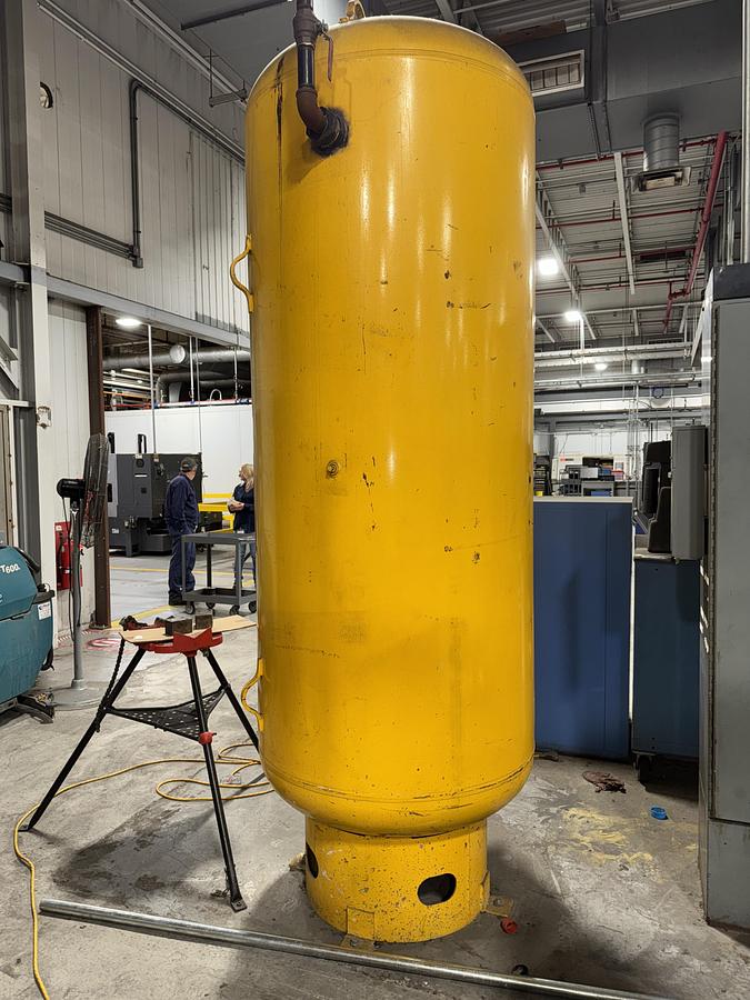

Horizontal front loading double wall vacuum furnace with graphite heating elements and autoclave door. Hot zone is constructed of graphite and ceramic blanket. Pumping system consists of Stokes 412 roughing pump and a Stokes 615 booster. There is an external 50 H.P. cooling blower. Furnace is complete with a loader and includes a spare complete hot zone NEW IN CRATE, NEW spare Stokes 615 blower, NEW spare Stokes 412, NEW Moly work tray.

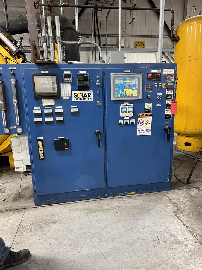

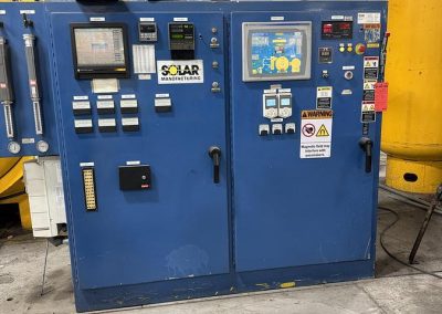

Mounted and wired in a free standing panel includes a Honeywell programmable control, Eurotherm 6180A paperless digital recorder, Honeywell UDC digital high-limit and Televac MC 300 vacuum controller. Allen Bradley PLC with Allen Bradley PanelView Plus 1500 HMI.
Year: 2007
Serial Number: SF-69
Stock Number: 7880
Work Area: 36″W x 36″H x 48″L
Max. Temperature: 2850-F
Power Requirements: 460/3/60/340 KVA/426 Amps
