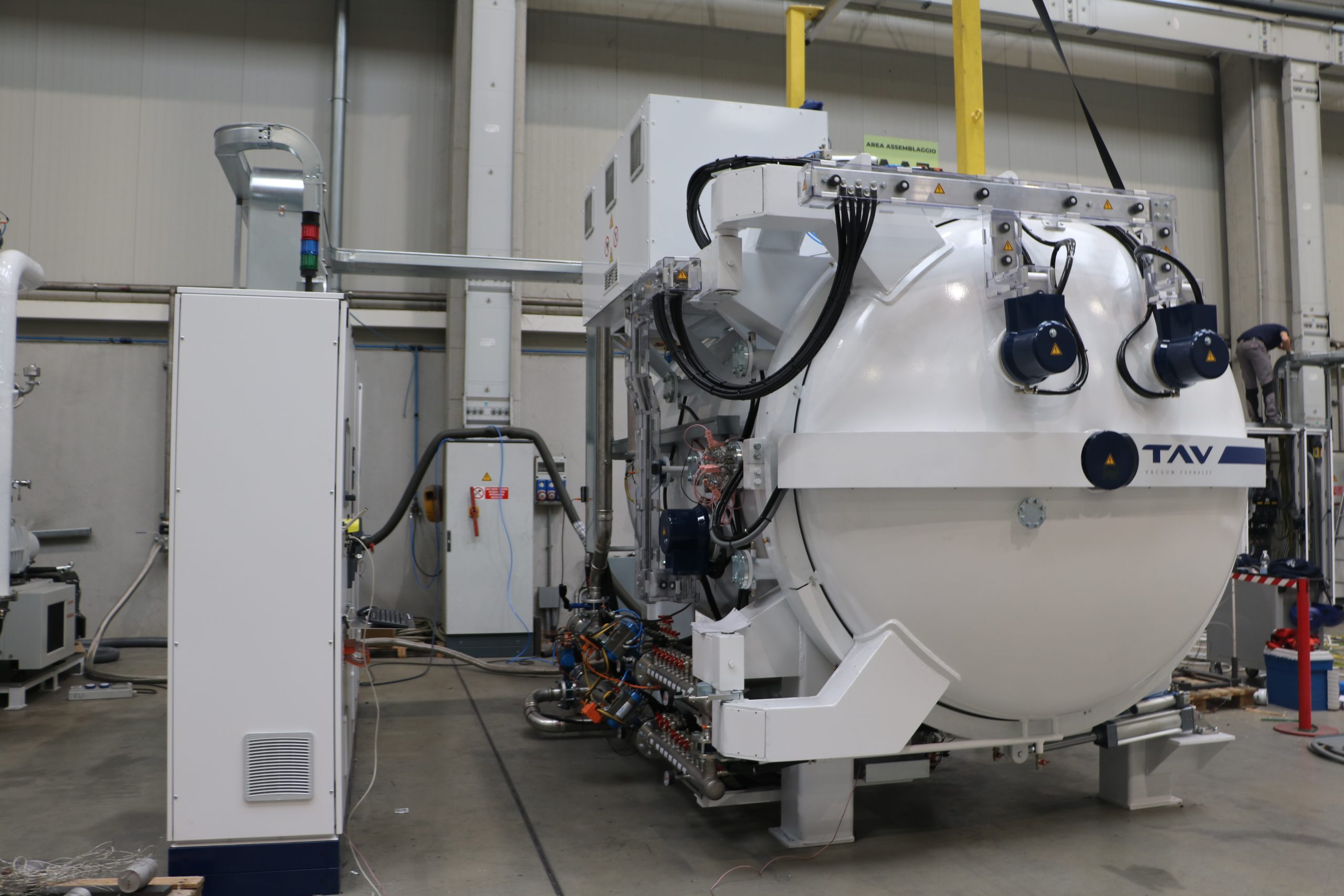

Item # VF467 TAV 10 Bar Vacuum Furnace 36″ X 36″ X 48″-Unused!
Manufactured by TAV, one of the largest vacuum furnace builders in the world, this is a Model TAV H9-S Vacuum Heat Treatment Furnace”. Working dimensions of 36” x 36” x 48 with a load capacity of 2,200 lbs.
Specifications;
• Maximum temperature of 2700 °F (operating at 2600 °F).
• Convection Heating – Faster heating cycles with temperature uniformity of ±10 °F between 570 °F and 1000 °F.
• Partial Pressure & Forced Cooling – Controlled inert gas cooling (Ar, N₂) from 13 psi to 166 psi (approximately 10 Bar) with inverter-driven speed control.
• Graphite chamber with rigid graphite boards, sacrificial foil, and reinforced CFC profiles for durability.
• Multi-Directional Gas Flow – Adjustable flow from top and bottom for optimized quenching.
• Instrumentation & Connectivity – Nine (9) load thermocouple connections, teleservice readiness, and Industry 4.0 compliance.
Options;
• High vacuum package (down to 1E-5 mbar) for processing sensitive alloys like titanium.
• AMS2750H compliance package with digital recorder and dew point meter.
• Closed-loop water cooling system with emergency backup.
• Electrical loader (48” capacity), spare parts set, and barcode recipe management.
This furnace is unused and ready for immediate delivery. Very attractive pricing. Please contact us for more details.
