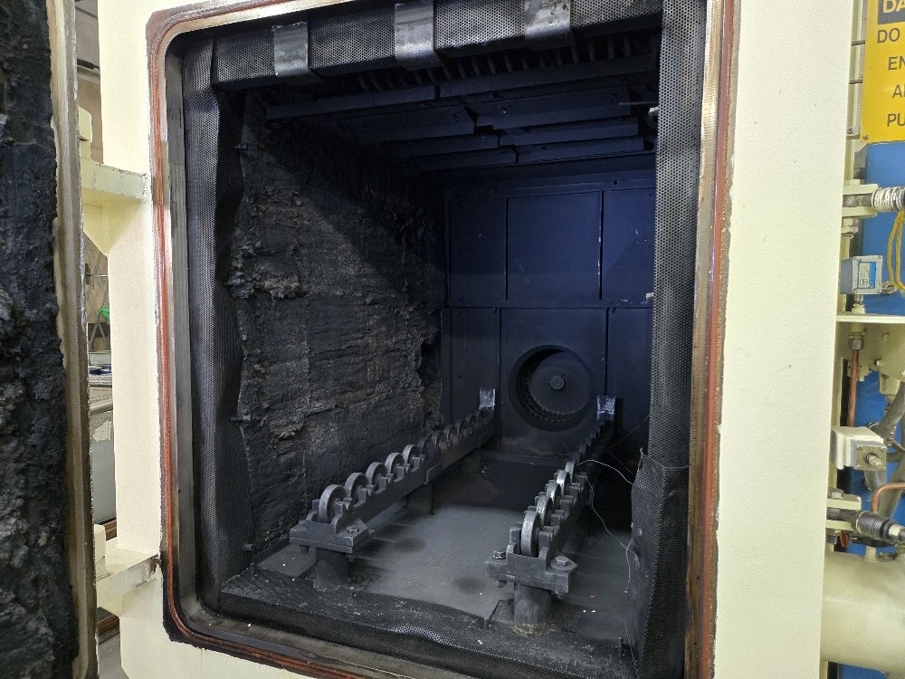

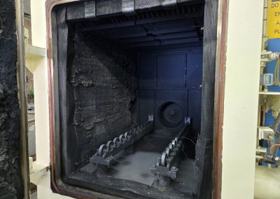

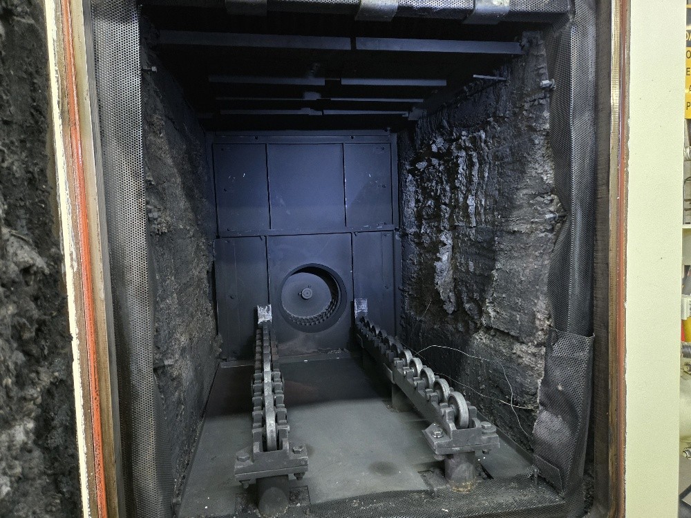

Item # VF471 Ipsen Vacuum Temper With Hydrogen Addition
Manufactured by "Ipsen" this is a Model ADIV-5-E temper unit, Serial Number 60529 with "Dry Coolers" water cooling system.
Â
Working Dimensions of 36" Wide X 36" High X 48" Deep
Maximum Operating Temperature of 1250F, Clean-Up (Bake-Out) Temperature 1650F +-10F
Hot Zone 7" Fiberous Insulation
Maximum load 4,000 pounds
301 Roughing Pump with 412J-MB Vacuum Booster
Hydrogen Atmosphere 3.9%
Nitrogen Backfill with 10HP Blower
Honeywell Controllers
575V/3ph/60Hz
"Dry Coolers" Water Cooling System Model AVR-31, Serial Number J-2839
Â
System is currently installed but not in use, excellent condition. Operational Guide & Vendor Document Binders included. Asking $85,000 USD.
