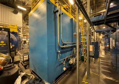

Item # T435 Wisconsin Oven Batch Oven 72" X 48" X 48" 1200F
Manufactured by Wisconsin Oven in 2007 this is an Electric Batch Furnace, Model 7/3/5-E13, Serial Number 106200701;

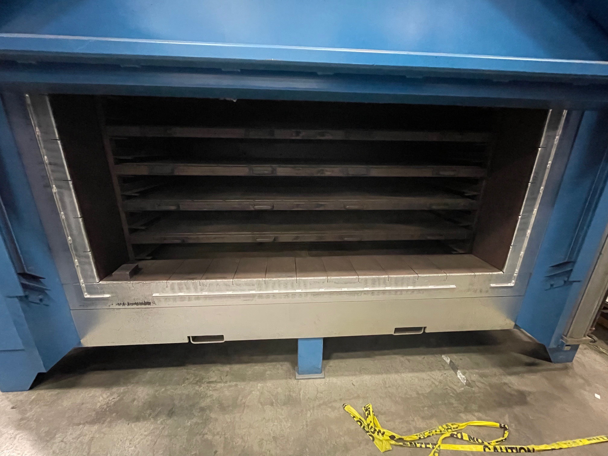

Internal useable dimensions: 72” wide x 48” high x 48” deep

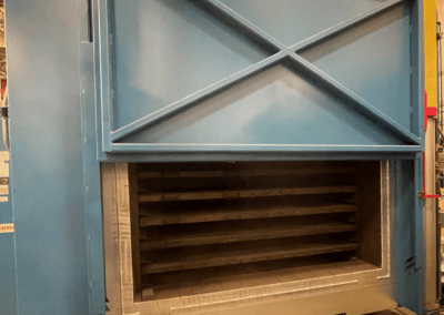

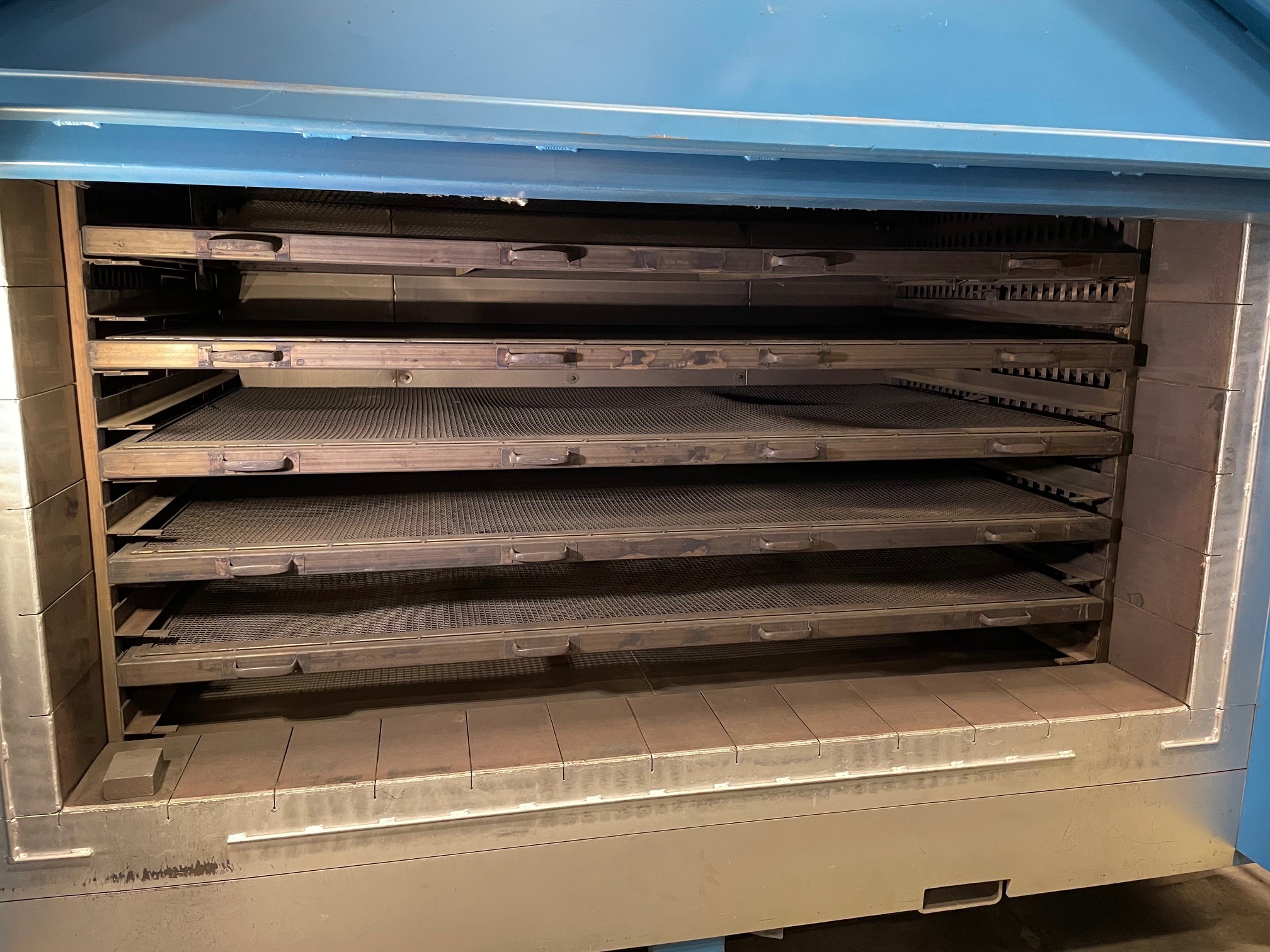

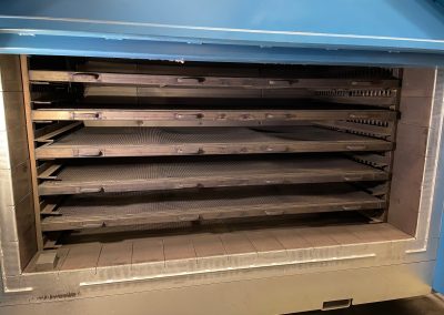

Fitted with ten (10) removable shelves, 72” wide x 48” deep with 4” separation
Operating Temperature: 1300° F Maximum, Temperature uniformity: +/- 25° F @ 400° F & 900° F
Input / Hr.: 144 KW, Voltage: 480/3/60
Controls: Honeywell with chart recorder
Features and comments
· Two (2) 1 hp vacuum pumps and one (1) 10 hp circulation pump
· Gate type up acting door - pneumatic with two (2) cylinders.
· Overall dimensions: 14’ high x 13’ wide x 6’ deep (approx..)
· Approximate shipping weight: 9,500 lbs.
· Safety interlocks
· Ex-major aerospace facility. Used as “burn off” oven for SPF and diffusion bonding work.
· Has seen little use. New cost Was $250,000 in 2007
This furnace is in excellent condition, is complete and ready to go. Asking USD $65,000.00 loaded on truck.
