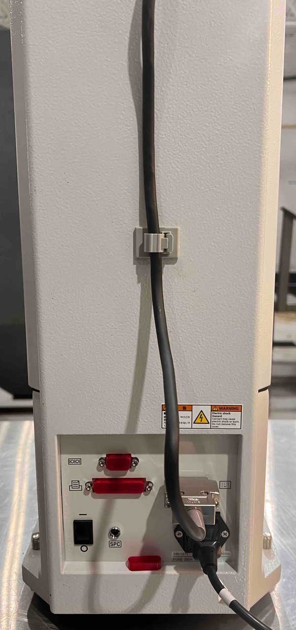

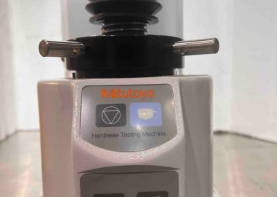

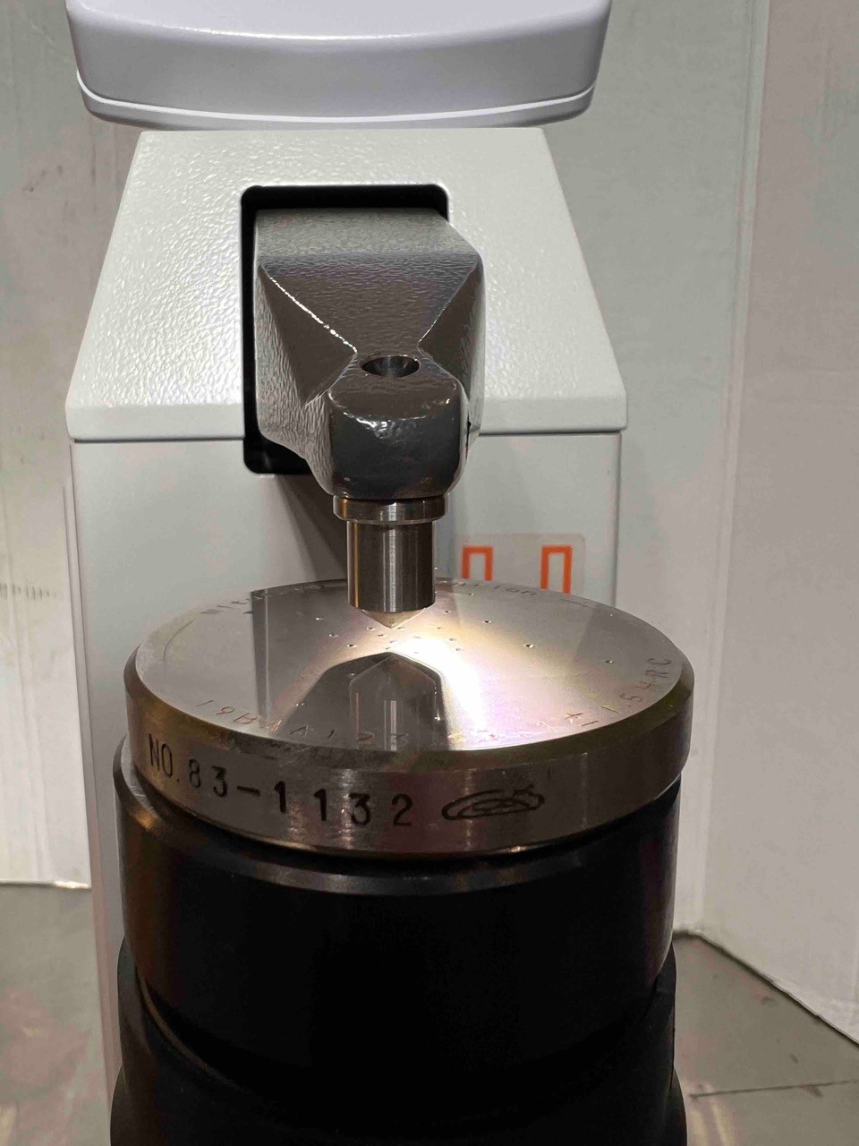

This Mitutoyo HR-523 Rockwell tester is new, never installed. The unit comes complete with Power Z axis, one flat and one VEE anvil, diamond and 1/16" carbide ball indenters, 2 HRC and 1 HRBW Rockwell test blocks, and an HR30N and HR30TW test block, case, manual, tools and all certificates. Â Selling for just over half price of buying new from Mitutoyo.

Indenter arm: Features a dolphin-nose indenter arm for easy reach of interior (minimum ø40mm) and exterior surfaces.Â

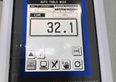

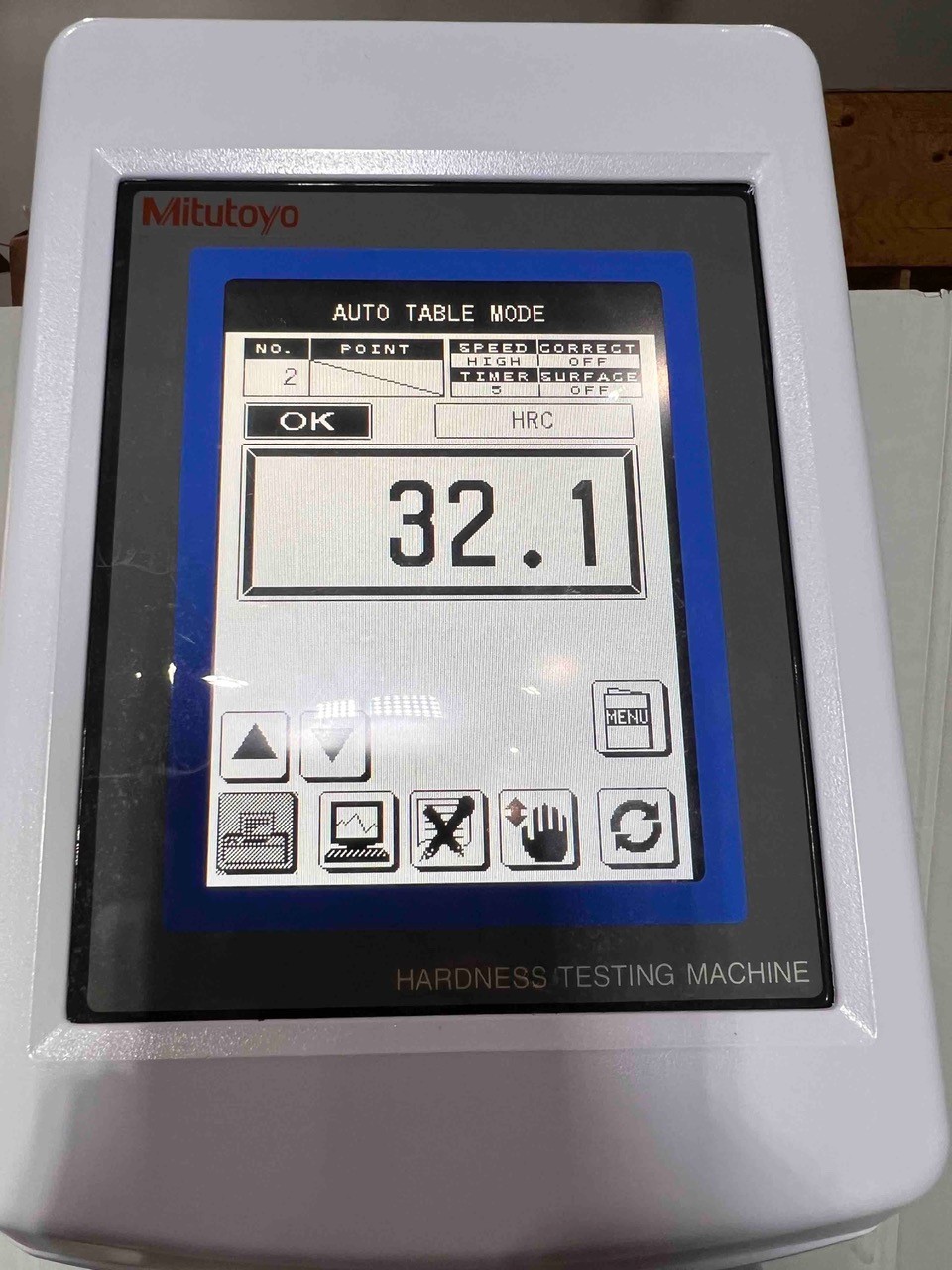

The touch-screen display shows hardness value, converted hardness value, test conditions, go/no-go tolerance judgment, and statistical processing results. It supports hardness conversion across numerous scales (HV, HK, HB, HS, tensile strength, and many more), data memory up to 1,024 readings, SPC calculations, histograms, and X-R charts. The "L" suffix denotes the large-throat (extended depth) variant, giving it greater clearance for testing larger workpieces compared to the standard HR-523.
