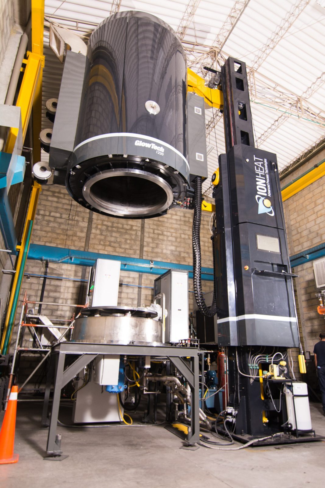

From Mr. Ankit Gupta, Director of commercial heat treater Modern Metals India we have this article about Plasma Nitriding, where and how you use it. In the first photo we see Gord Montgomery, Ankit and Rakesh, Gupta at the Thermprocess show in Dusseldorf, Germany June 2019. The second photo shows a typical Plasma Nitriding unit, one offered by Ion Heat.

Process details. Plasma nitriding/nitrocarburising is a modern thermochemical treatment, which is carried out in a mixture of nitrogen, hydrogen and an optional carbon spending gas. In this low-pressure process, a voltage is applied between the batch and the furnace wall. A glow discharge with a high ionisation level (plasma) is generated around the parts. On the surface area that is directly charged by the ions, nitrogen-rich nitrides are formed and decomposed, releasing active nitrogen onto the surface. Due to this mechanism, shielding is easily done by covering the concerning areas with a metal blanket. Plasma nitriding allows modification of the surface according to the desired properties. Tailor-made layers and hardness profiles can be achieved by adapting the gas mixture from a compound layer-free surface with low nitrogen contents up to 20 microns thick, to a compound layer with high nitrogen contents and an add-on of carbonic gas (plasma nitrocarburation). The wide applicable temperature range enables a multitude of applications beyond the possibilities of gas or salt bath processes.
