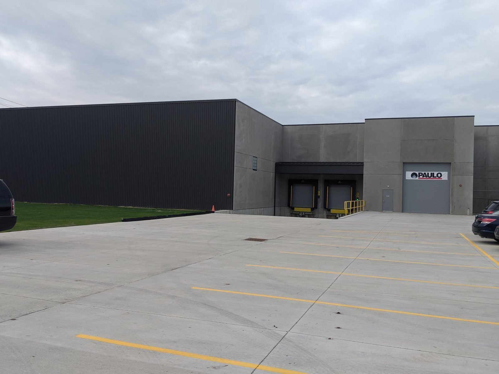

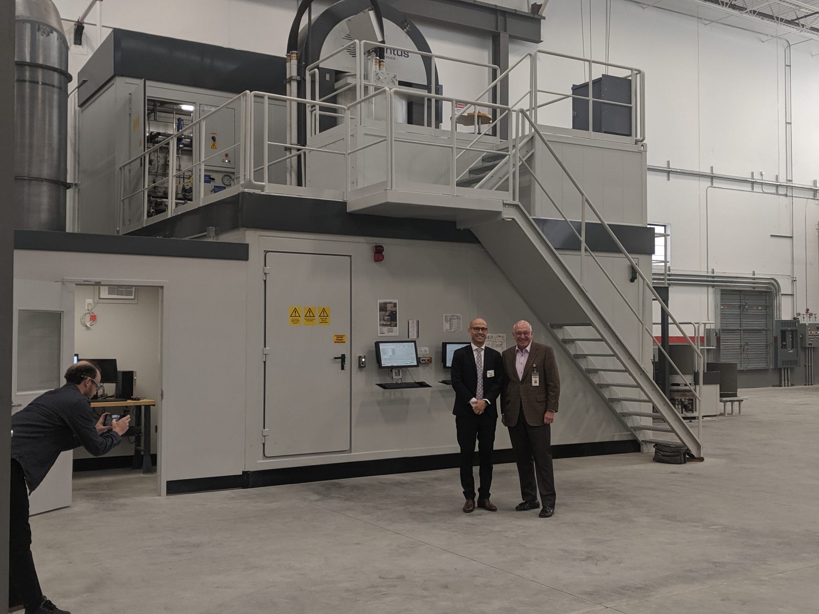

Yesterday we had two photos which were taken at commercial heat treat Paulo in Cleveland, Ohio, USA during their open house to showcase their brand new Quintus HIP (Hot Isostatic Press System) system. The “Hipping” process reflects a small but growing trend in the commercial heat treatment industry in North America with several companies entering the market in the past year. In July of this year we had a news item about this project and the company overall-this can be found below but at this point we can share a little more information with you. Currently this plant has a total of 41 furnaces, 35 of which are vacuum furnaces. The building expansion which is mentioned below and can be seen in one of the photos below will allow the company to install 12 more vacuum furnaces in the years to come as well as another HIP system. Overall the company invests over $10 million USD back into the company on an annual basis. You can see why this company has grown and prospered since it was started in 1943.

“Exciting news from Paulo’s Cleveland Division where the Hot Isostatic Press has been delivered and is currently being installed. The furnace arrived after a long voyage from Sweden where it was built by Quintus Technologies. The modular elements as well as the pressure vessel and yoke are being set in place currently. The installation is on schedule and the vessel is slated to be ready for production early September. The 30,000sqft expansion to house the HIP vessel is complete and will provide the Cleveland Division room for additional expansion to support customer needs. Rigging is nearly complete as the many large components are set in place, the heaviest is the yoke, weighing in at over 80,000lbs. The yoke contains the vessel while under pressures, which can reach 30,000 psi. Also pictured are the power and pumping modules which form the structure around the vessel. Paulo is excited to add HIP to its service offerings especially in light of the recent growth of additive manufacturing.
“Many of the products we heat treat are HIP’ed prior to us receiving them, adding HIP allows us to be a one stop shop for many customers as well as growing our presence in the world of Additive Manufacturing,” said Phil Harris, Marketing Manager. Installation and startup will continue for several weeks with both cold and hot testing and training to be completed by September. The construction of the expansion is nearly complete as seen below. Founded in 1943, Paulo is one of the largest providers of thermal processing and metal finishing solutions in North America. Headquartered in St. Louis, Paulo operates six divisions servicing the Midwest, Great Lakes, and Southeast regions of the United States and northern Mexico.”

Mr. Johan Hjärne, Sales Manager, Quintus Technologies, Mr. Ben Rassieur, CEO, Paulo
