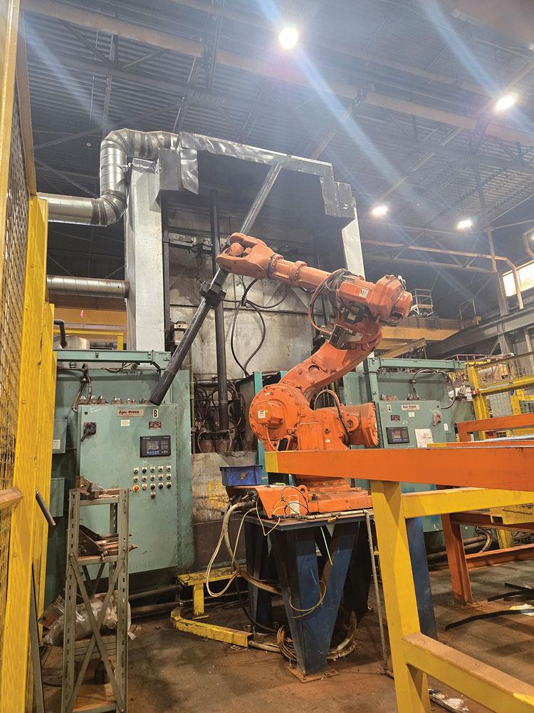

When the company first started the process, they had the drill rods thrown by hand into an induction scanner before being processed and straightened. Eventually, the company incorporated robotics and automated systems that sped up the process to help the shop keep up with the high-volume demand that its customers expected. The new heat-treating process for drill rods helps them to last longer and provide improved wear resistance. It also allows for the drills to be used in deeper holes.

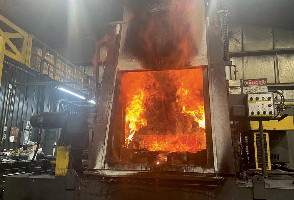

With a focus on high-volume production, the shop has added four automated drill rod cells with robotic handling and can process 20 pieces every nine minutes using these systems.
“We were previously renting a facility in Coniston, Ont., but we decided that it was important for our expansion to purchase our own property,” said Sidun. “We have 9 acres of land available to us along with access to 12 CN rail tracks that come right into the building. It was a big move, but it allows us ample opportunity for growth.” The main building is currently being used for the shop’s drill rod segment. It includes three stress-relieving furnaces, including one of the largest in the region that reaches temperatures up to 2,000 degrees F and accommodates parts up to 22 ft. long. The company also does all annealing and normalizing in this building.
With a focus on high-volume production, the shop has added four automated drill rod cells with robotic handling and can process 20 pieces every nine minutes using these systems. “We are geared for high volume,” said Sidun. “Currently, we are steady at two shifts. We have room to expand into a third shift if we need to.” The second building is focused on heat treating with furnaces and includes six temper furnaces, all of which work off of one fairly large-batch IQ. The shop can do varying processes from oil quenching and tempering to carbonitriding. It also invested and expanded into coatings with a new paint shop and shot blaster on one end of the building.
