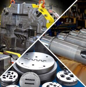

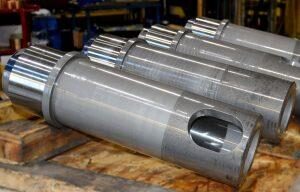

“Castool has dedicated heat treatment and nitride facilities in Canada, Thailand and Morocco. Each has 12-bar vacuum heat treatment furnaces capable of heat treating 15,000 lbs and vertical tubes up to 65” in length. We can nitride virtually any heat treated tool also in vacuum. The adjacent vacuum oven is located beside our Kenitra facility. In Canada, Castool currently heat treats more than 2 million lbs. of H-13 a year. The volume, sizes and specifications reguired by the market are constantly increasing. With the recent use of Gigapresses to make aluminum automotive structural members, the maximum length of a shot sleeve has increased from 50” to 65”, and is expected to increase again to more than 80”. Castool is working with Ipsen and Nitrex to equip a state-of -the-art heat treat facility in Newmarket, Ontario. The facility will start operation in spring of 2022, and will be fully operational by fall. We will offer vacuum heat treatment and nitriding services commensurate with the market demands.
Castool is a division of Exco Technologies Limited. It was first established in the early 1980’s in Scarborough, Ontario. In 2006, a new 40,000 sq ft facility was built now expanded three times to 80,000 sq ft on the outskirts of Uxbridge, Ontario – a small, historic town about one hour northeast of Toronto. It is now the head office, design and manufacturing plant for Castool Tooling Systems, employing approximately 140 skilled people, and servicing the global aluminum extrusion and die cast industries. About 90% of these sales are exported from Canada and 70% are related to Automotive.”
